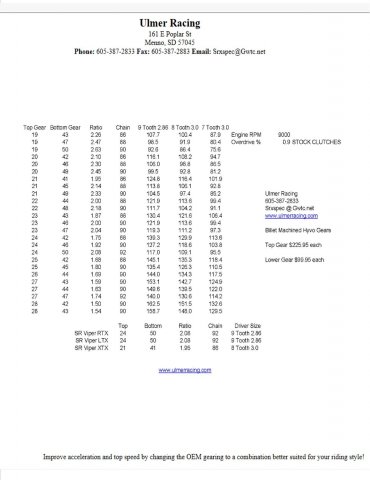

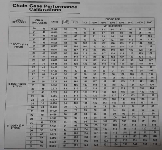

There are many options available and the stock setup in the XTX leave a bit to be desired as far as I am concerned and once you add hp it is really limiting the sleds performance. The stock gear quality is suspect but I have been running them for 3 yrs with lots of boost and no failures. I have at least 4000 miles on the set from the 14 XTX run te whole time at over 230 hp and no problems. the 15 now has ulmers $$$ gears ad chain with 26/44 gears and it is fantastic pulls like a freight train at the bottom and flat out hauls the mail to 124 mph on the top end. with some aero changes I am hoping for 126 on the 15 this yr. The chart from Ulmer states 134 mph in this set up but no way. At 10.5 lbs of boost 265 hp with overdrive at 9100 rpms 124 was the best on hard packed rail bed. maybe 2 to 3 more on ice.

Ulmer quoted me around 200 just for the top gear.
