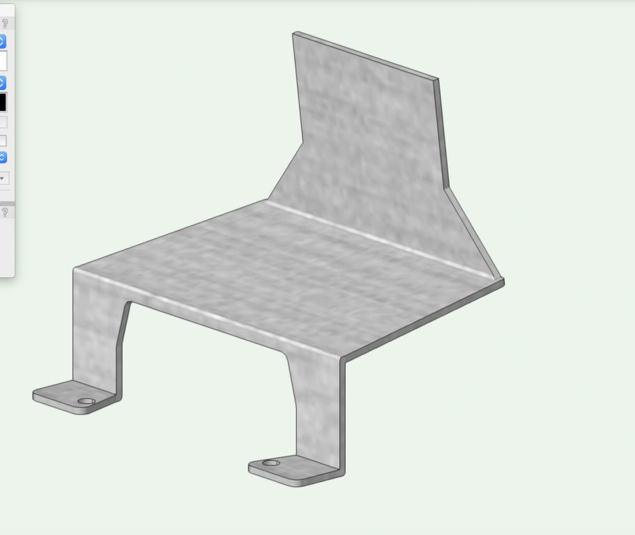

Yeah my phone charging case is currently mounted just as twyztid did. Ram diamond base plate screwed to dash, short arm, diamond plate adapter to 3D printed adapter to Arkon case. Ram mount possibilities are almost unlimited. I am replacing that with the OSP plate. I wasted some time this morning and modeled it up roughly.

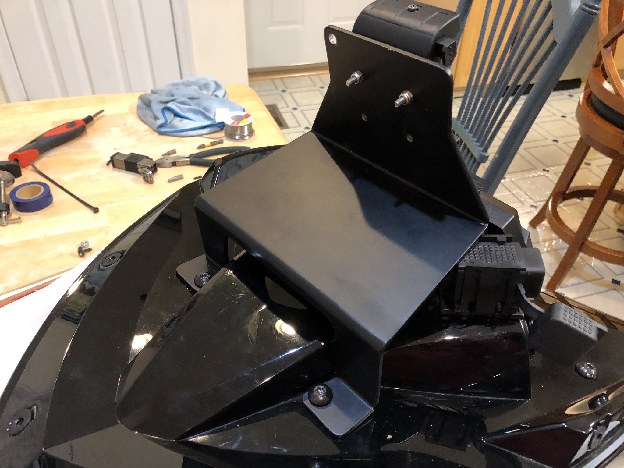

I finally got around to moving my GPS from the riser to the OSP bracket over the gauge.
This shows how I mounted my Arkon case where my iphone rode last year using Ram 1” ball components.
IMG_4681
IMG_4682
I routed the power for the Amps cradle through the bottom hole from the previous ram mount location.
IMG_4684
I wired up my Amps cradle, my RideLite and a Mic Tuning dual USB charger to the wiring for the accessory socket. All are when key is on (engine off or on).
IMG_4687
I always use a tether for my GPS so I drilled a hole in the top corner.
IMG_4683
I found the screws for the black cowling just barely long enough where the plate mounts. I may order new or source longer screws.
IMG_4686
Back together all powers up correctly.
IMG_4688
IMG_4681
IMG_4682 I routed the power for the Amps cradle through the bottom hole from the previous ram mount location.
IMG_4684I wired up my Amps cradle, my RideLite and a Mic Tuning dual USB charger to the wiring for the accessory socket. All are when key is on (engine off or on).
IMG_4687I always use a tether for my GPS so I drilled a hole in the top corner.
IMG_4683I found the screws for the black cowling just barely long enough where the plate mounts. I may order new or source longer screws.
IMG_4686Back together all powers up correctly.
IMG_4688

The cable that is connected to the cradle, can you unplug it? Wondering if my cable can just plug into it.
actionjack
- Apr 9, 2005
- 2,519
- 623
- Westminster, Maryland
- www.inspectorjack.com
- 2017 SideWinder LTX-LE
The amps cradle cable is hardwired in the mount and under the dash all of my connections are soldered and heat shrink protected. You could create a plug set up and you can route the cable under the corner of the gauge without having to add a hole to route the wire.The cable that is connected to the cradle, can you unplug it? Wondering if my cable can just plug into it.
