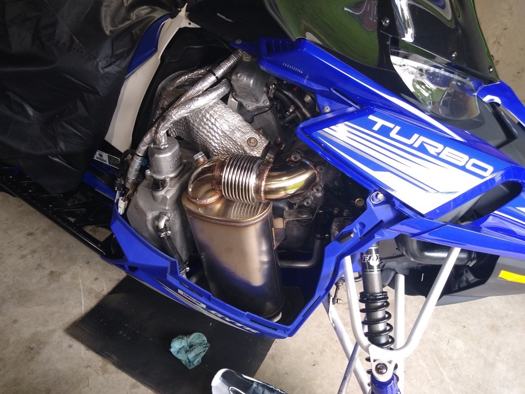

Well...after suffering disappointments all last year, I believe this year is going to start off fast & furious. Well...

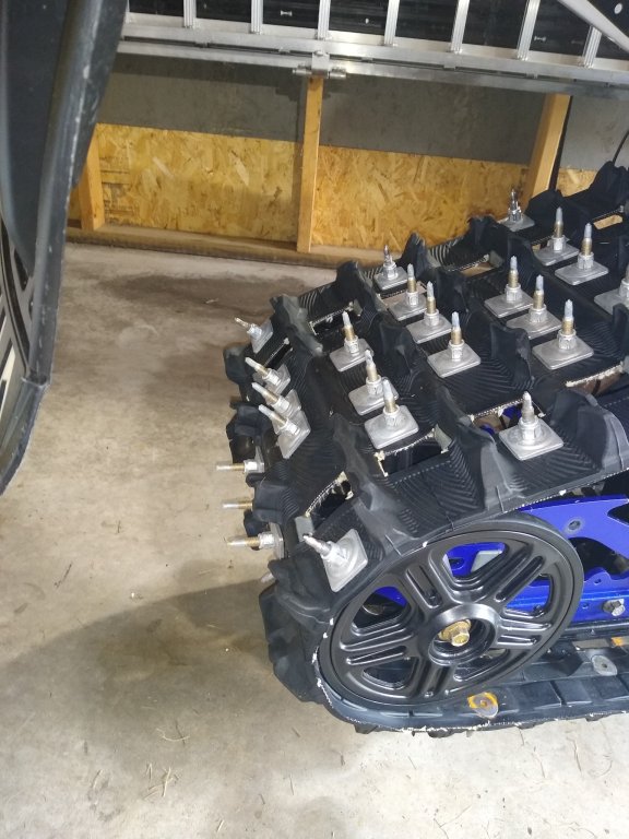

Sleds been completely gone over & maintained. 192 studs, Four helixs & more upgrades on the way. Including draggy!
Ive learned so much in the off season either here & talking with others, I'm super confident & stoked. Got a chance to talk (2hrs) with Steve (ClutchMaster) for any that care, he's doing great!
I honestly believe that I should have left my sled untuned but tweaked, to achieve the desired results. It is what it is. All my updates will end up here. Thanks, you guys!!!

Last year, 144studs. Hey...I'm trying. Lol.

So, I'll start this year with 192 studs, as mentioned. TD 3" SQ and a taller gear.

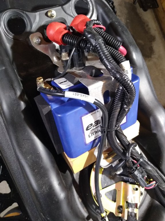

Speed secret #1. Lite is right! Taking 20lbs off my racing weight today. Takes longer then you think!
Oh, yes the battery is only 10lbs of loss. going on a diet for the other 10lbs. Lol.
I need my fighting weight to be 180lbs.
