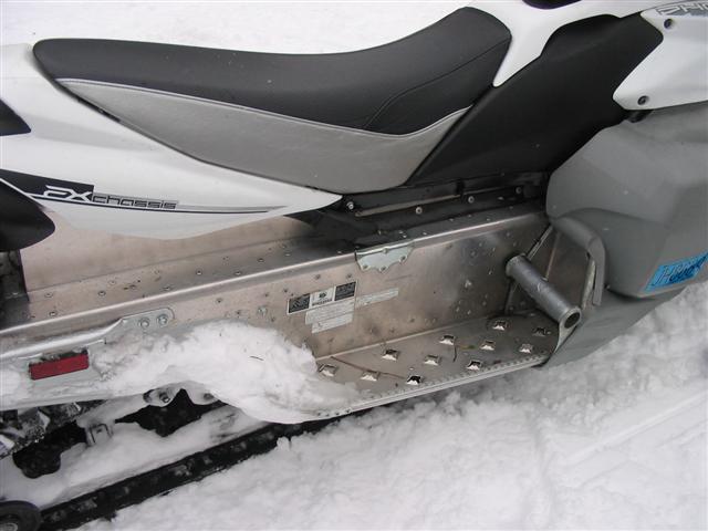

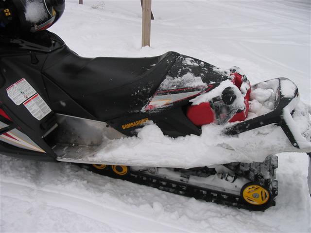

As I stated in the review I love this sled so this project was worth it. When riding with a friend in deep powder that has a RS Rage it occured to me that his footrails are always clean. So the brain started working and the project had to be done.
I looked at a Rs Rage and thought that would be way to much work to route it around the tunnel. So I was browsing Ebay and saw left and right side footrail heat exchangers from a 2003 Polaris XC 800. They had in and out ports at the front and I was the only bidder shipped to the door for $29.99 excellent.

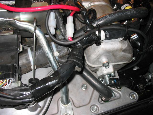

A bit off cutting took place to get them to fit the short footrails and the delta box portion of the frame. The existing support piece had to come out, took em in to be welded up and mounted them on. Piped under the engine in front of the oil drain plug and back behind the starter with aluminum tube. Made the final connections with coolant hose and anchored as needed.
It was a bit more complex at times but it was nice to see it finished. On the original test ride I noticed the heat exchangers were warm but could be warmer and that was at 45 degrees. So I removed the radiator and fan yes thats right, and went and tested again about 20 miles and no overheating. After the ride at operating temprature I let it idle in the garage for 13 minutes before it shut itself off.
The final test came on Saturday at 45 degrees in wet snow for 70 miles and no matter what I did it would not overheat. If it wont overheat with these condions it will be just fine any other time. Here are the pictures for any interested in tackling the project. Total cost to do the job was $200.00, it took more time than money.

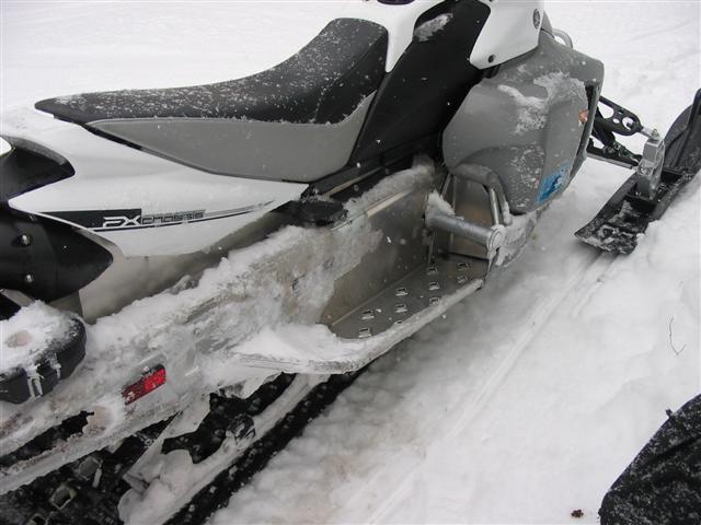

For those of you wondering how they work check out the pictures. We got 18" of snow, wet on the botoom powder on the top. It sure is nice not to digging that snow off those foot rails. That was after 20 miles of BUSH riding.

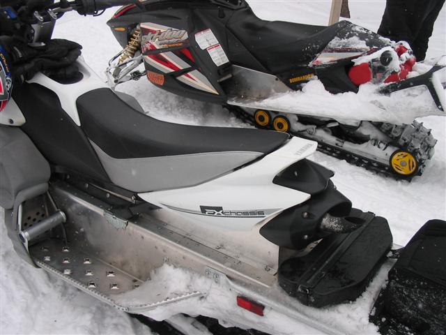

Check this out on a 79 mile bush powder ride, pictures of a Doo with me. This is why it was worth a whole days work and only $200.00. Temp was 28 degrees.
