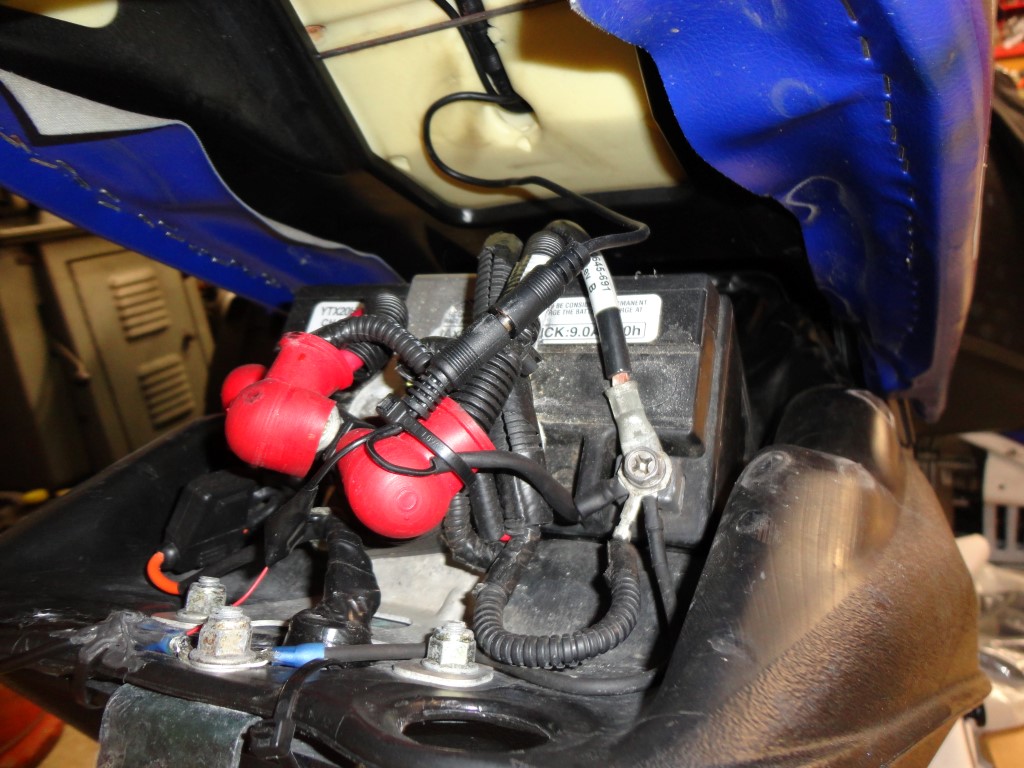

Yes direct. You could also go into the key switch or use the accessory plug in thats on sled. Just remember that if you go direct you run the risk of leaving it on when stopped or not using sled. Or go with Cannondale set up with the led light.. tells you"your forgetting something" !Did you wire it directly to the battery? I just picked the kit for my LTX SE.

Here you go. Nothing fancy but has worked well for last 2 seasons.Thanks for the tip. I like the idea of the light too. A pic would be great.

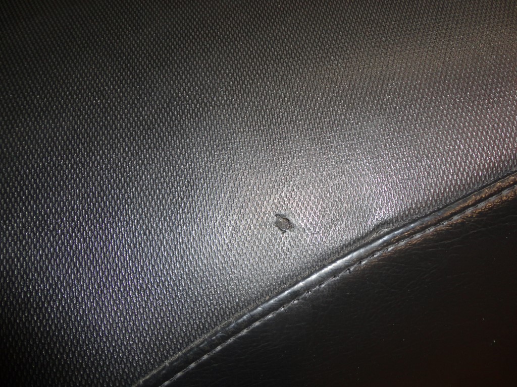

Update:
Brother was riding my Viper and it was in 20's. He complained seat was burning his butt. Sure enough and it also burned his pants a little. So 2 seasons about 4-5000mi out of the Single power Heat Demon and its shot. Looks just like when a grip heater shorts and burns a small hole in grip except this was my seat. Was nice while it lasted though.
