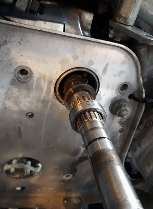

i am about ready to install the rear chain case cover....not sure what goes before on secondary shaft (upper shaft) could not figure it out from picture in shop manual.
Some Vid's on a Vector. Maybe you can tell by watching. It would help if it was in english !
Ok thanks. Got it all together
No parts left so I must have done something Right!!
when you put the reverse gear in there is a metal plate and spring with a long bolt that loads the gear make sure you blue locktite that bolt in or it will loosen and eat through the outer cover
