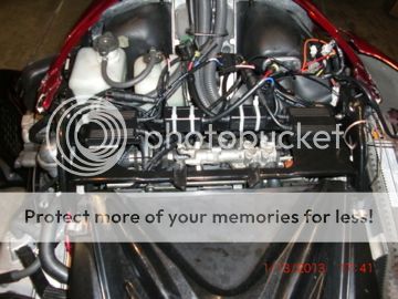

I got Grizz back 2 seasons with his install style. Had ddm tuning 35 watt 4300k bulb kit with sled start patch cables and was plug and play. Now this year upgraded to 55 watt bigger ballasts with same bulbs and wiring. Changed install to my style to free up air intake area and make coolant bottle access a little easier. Here are all the pics. I used rubber well nuts to mount and double face tape to prevent chaffing. Hope this helps give other ideas. Open to critics as well. More input the merrier. Thanks
