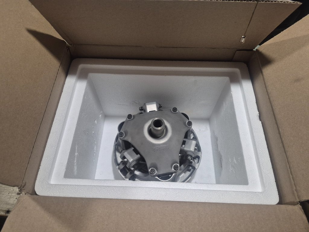

Cryotherapy is a deep freezing (-185°) process, opposite of heat treating, with similar outcome.
Tapp/STM are great options. But somehow when someone says, "you shouldn't or can't do that" it makes me want to do it more. Even if it ends up costing twice as much.
All boxed up for ya! If everything goes well, it should be able to take a healthy beating.
