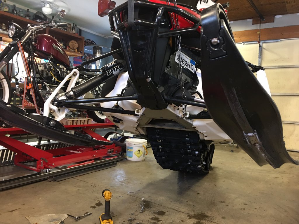

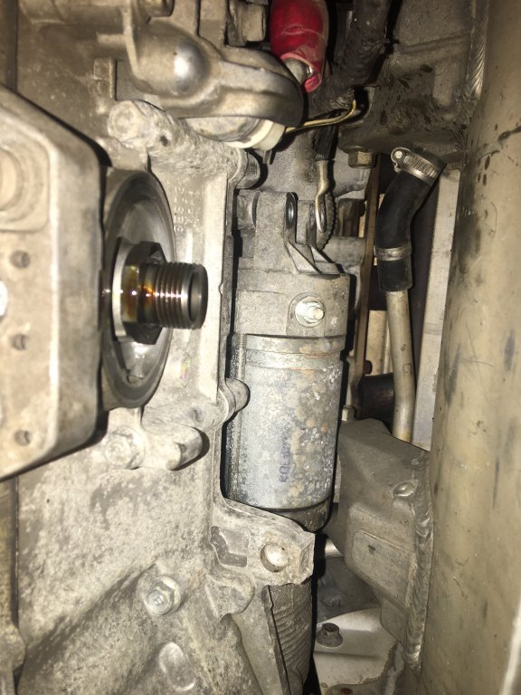

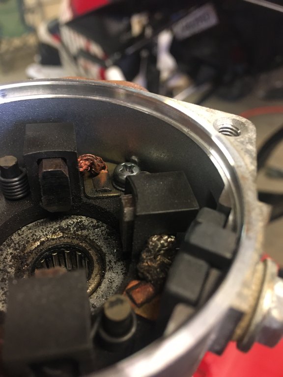

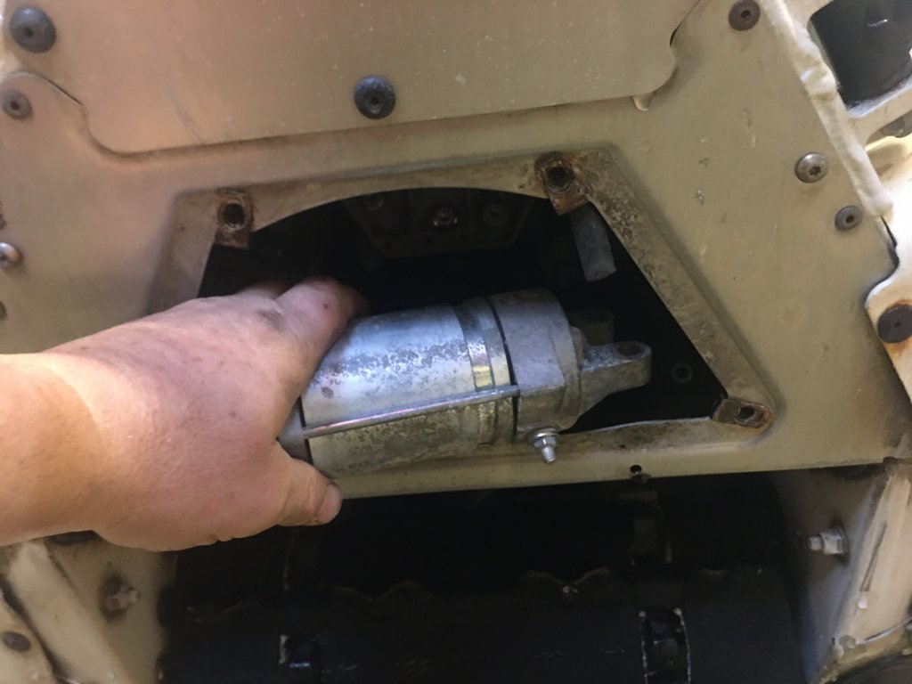

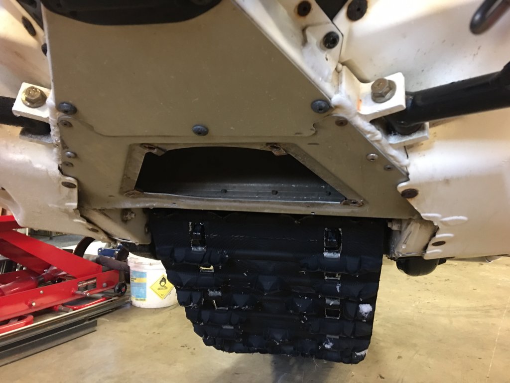

Swapped out my 2015 Viper starter tonight. Very easy 30 min job and the new starter definitly is rolling the engine much faster. After the replacement I separated the original OEM starter and was surprised that the magnets were still intact. The issue ended up being worn out starter brushes. I'll probably replace them and keep the starter as a spare.

Great job! The pics are a nice touch. Once the two bolts are out does the starter just pull back to remove? Did you go with the OEM replacement?Swapped out my 2015 Viper starter tonight. Very easy 30 min job and the new starter definitly is rolling the engine much faster. After the replacement I separated the original OEM starter and was surprised that the magnets were still intact. The issue ended up being worn out starter brushes. I'll probably replace them and keep the starter as a spare.

Yes, once the bolts are out it slides back. There's an o-ring that seals the nose cone of the starter to the engine block so there will be a little resistance pulling it out.
I've replaced many starters over the years in Yamaha engines and other powersports engines. I typically don't replace them with OEM starters due to cost and the fact they don't seem to last. I usually buy starters from DB Electrical and have had good luck with them but the Yamaha 3 cylinder starter is currently out of stock at DB so I ended up ordering from Rare Electrical which I've also purchased from in the past and so far haven't had any problems.

I replaced the starter today, what a difference in cranking speed then before. I pulled apart old starter and can't see anything broken or out if place (magnets all good). The brushes are definitely worn but all still there and intact? The new starter sure spins it up much much faster and have had no issues so far. I also replaced the plugs with iridiums at the same time, the old (original) ones looks fine. Fingers crossed it will be back to starting like it always did before.Yes, once the bolts are out it slides back. There's an o-ring that seals the nose cone of the starter to the engine block so there will be a little resistance pulling it out.

Now that I look back at your pics, my starter and brushes look pretty much exactly like yours...I replaced the starter today, what a difference in cranking speed then before. I pulled apart old starter and can't see anything broken or out if place (magnets all good). The brushes are definitely worn but all still there and intact? The new starter sure spins it up much much faster and have had no issues so far. I also replaced the plugs with iridiums at the same time, the old (original) ones looks fine. Fingers crossed it will be back to starting like it always did before.
