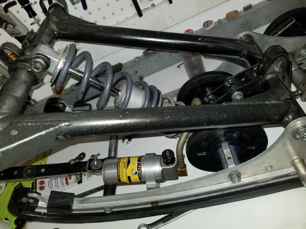

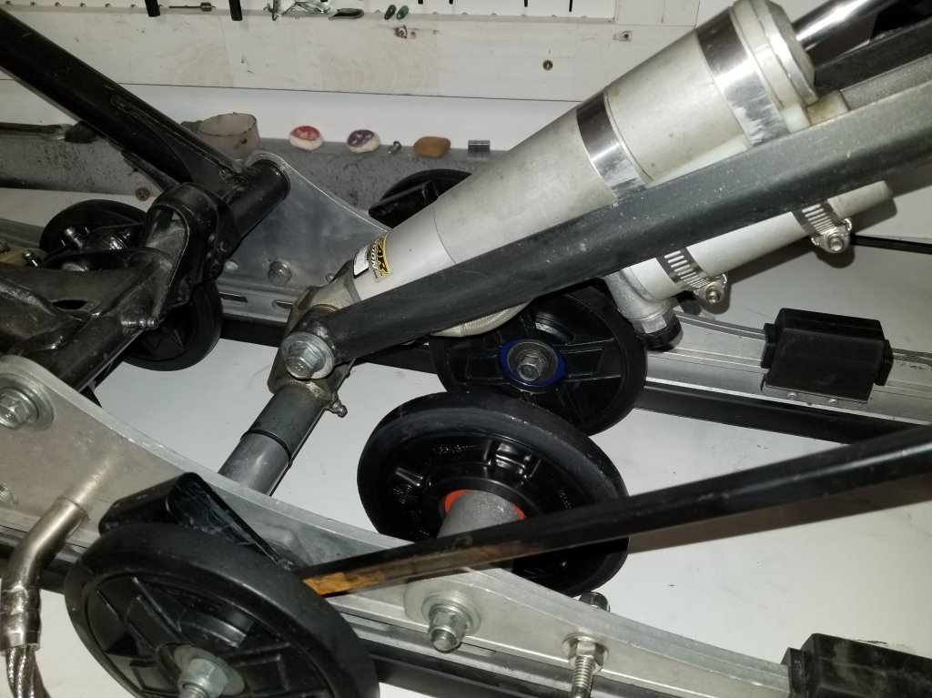

Just did mine tonight. The lower shock mount bolt hits the inner right wheel so you have to release that axle from the skid rails. Simple to drop the entire skid and remove (four bolts on tunnel) and then you can go through the entire skid in an evening or two. The hex screws on the sleeves were not lock tighted in on mine, likely will put back with blue LT.
Matthew457
Stupidest set up ever that you have to take off the inner bogie wheel to get the shock off, especially that it’s such a b*tch to get those 2 bogies off. Just brought my shock in to get rebuilt since I might as well get it done while I have it all apart. Got the shock back this week and gonna be putting everything back together Saturday, then I think my sleds good to go for the winter bring on the cold weather and then #*$&@ ton of snow plsJust did mine tonight. The lower shock mount bolt hits the inner right wheel so you have to release that axle from the skid rails. Simple to drop the entire skid and remove (four bolts on tunnel) and then you can go through the entire skid in an evening or two. The hex screws on the sleeves were not lock tighted in on mine, likely will put back with blue LT.
View attachment 132489 View attachment 132490

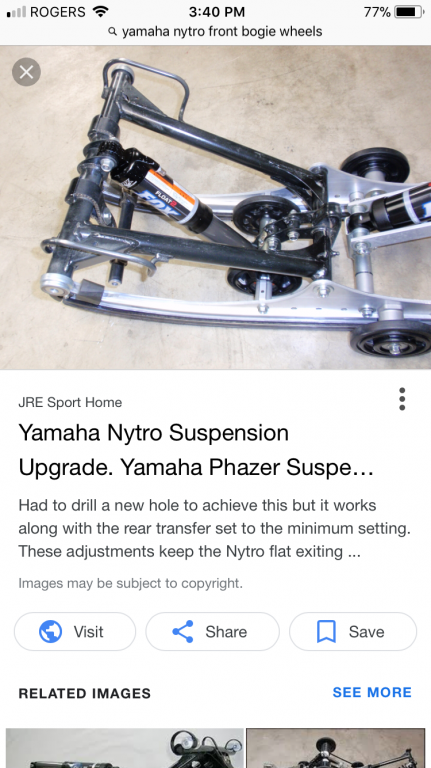

Drill a hole through the wheel. I'm thinking arctic cat used to build some of there sleds that way with a hole to slide the bolt through.
Hooray!
- Aug 12, 2017
- 707
- Maine USA
- 2009 Yamaha FX Nytro XTX
1998 Yamaha VMAX 700 XTC
I thought the same thing but I am sure one engineer is disconnected from the next one! That is an interesting idea to drill the hole through the wheel... dropping my skid was simple, will become an annual ritual as everything is right there, grease, clean, replace vs. on your ear under it.
