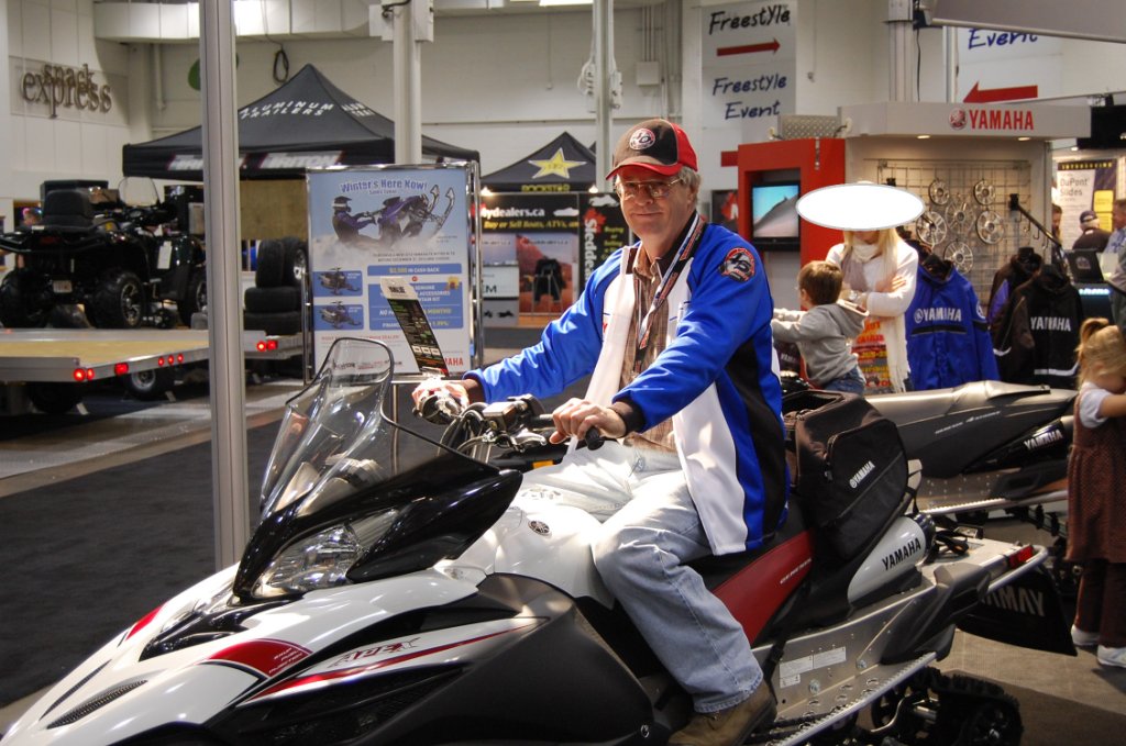

A sled mag writer (thanks Hal) gave me the jacket after seeing the introduction of new sleds
in 2022 . 45 th badge on arm . Newest pic on back is a 2013 apex like the
one I'm sitting on. Got my 40th ball cap on and found a salesman more than
willing to take my picture. He maybe thought I might take less than 14 years
to buy one .. lol.
If I get one , is my GMC with 6.5' box and pro tailgate long enough
or just pay the fuel and take my enclosed 7x18.. Pro tailgate nice but fragile.
Ron

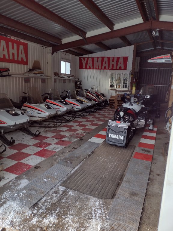

Waiting for some warmer days to investigate clutch engagement. Have seen some
posts here about speeds , belt dust and different springs (pink/blue / pink).
The seller commented that is has come to the right home with all of those "elders"

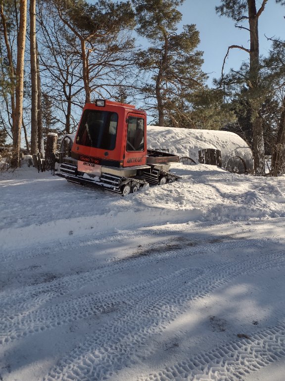

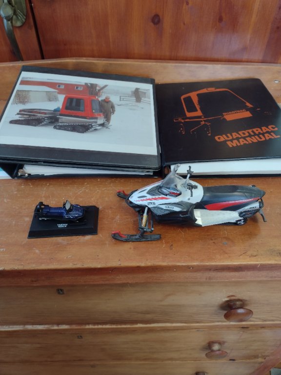

parked with it. My wife had me take a pic of the quadtrac leaving the property
as it was time for some else to look after it and I needed the room.
I had a desire for quadtrac since the 70's , got it 2011.
I had a desire for a VK540 and got the model about 5 years before sled.
I had desire for 40 Anniversary Apex and bought the toy and the jacket in 2008.
Glad to have 2013 in 2026.
I don't expect to live long enough to get the real John Deere 9400T to go
with the model sitting above my computer ..LOL

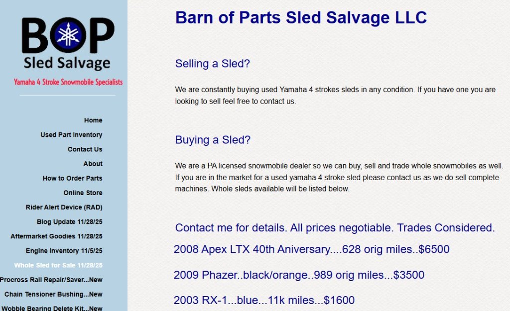

Congrats on the Apex! Best color combo in my opinion. Barn of Parts Soft Start spring will get your engagement down and it doesn't affect the rest of the RPM range. I added it to my 2013, 2 years ago and it makes loading and reversing much more tame.

Careful Ron, Travis also has a 40th Anniversary Apex for sale as well...
