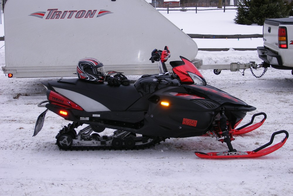

My 06' Attak is developing a small tear in the seat at the bottom edge near the fuel tank. Are there any tricks to keep the tear from growing? Its just barely knicked now and I am afraid its going to open up into a large tear if I dont do something. Any ideas?

Not sure if you would need a new cover but if you are planing to replace the foam with a stiffer type and possibly more of it, it may not be a bad idea. Also I would trim or at least reshape the area in the front of the seat where it meets the tunnel. That's were I had the issue anyway. Here's a pic of what the seat cover wold look like.
