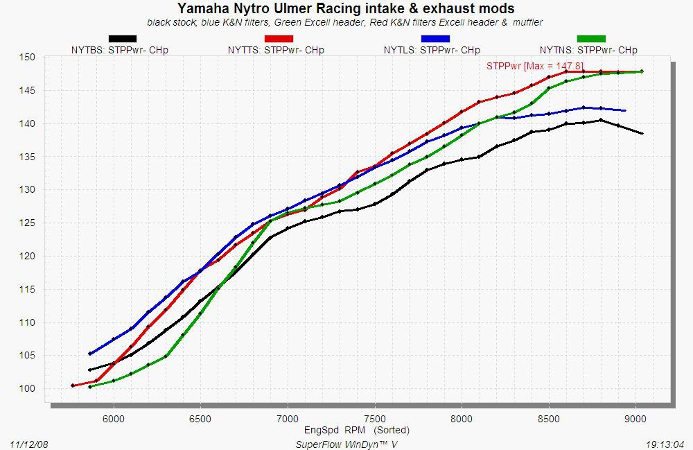

Mine made 146.3 at 9200 rpms with filters, plugs, Header, PC111 and an ignition module. the Best MPH I saw out of my stock was 102 the best I saw out of it modded was 113. When we added an after market muffler mine made 150 plus hp.
Here is a Dyno Sheet from dyno tech. the max HP made with a full system excel, filters, plugs, and a Pc111 was 147.8 on this particular sled.
Keep in mind every motor is different. But this is a base line.

Wow, The filters made power everywhere, especially down low. The headers really wake it up up top too. I would have expected the reverse from those two mods
Great info dirk, thanks! That is the exact setup i have on my sled. Always wondered what the dyno would read

Isnt that interesting..if any of you guys remember the recent debat with the cheap bolt on boost....you would lose the filters and add a restrictive plenum at least in the low to mids..telling!
