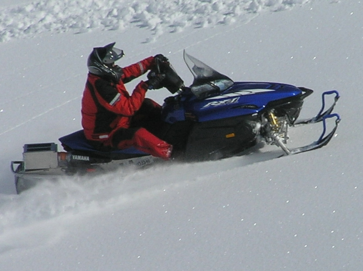

This is what I ran into with the stock configuration. On the Vector, Bender was running a dual exhaust system. This put a tremendous amount of heat at the intake of the turbo. Under heavy powder and boondocking conditions the sled would load up from all the hot air it would pull in (due to lack of air flow across turbo while snaking through the trees). In fact, one trip it got so frustrating that I had to go back. That night I installed the intake as the pictures show and I have never had any trouble since.
The key is to use a silicone impregnated prefilter (eliminates the freezing of mositure to the prefilter; just tap it when snow sticks to it and it cleans right off) and a fitting that kicks the filter around behind the seat so you don't kick with your foot. My brother actually uses a 180 to get it right behind the seat. The fitting I used was a vacuum cleaner brush adaptor from Home Depot. I just pulled the brush out. It is made of plastic (light weight) and works great! i would suggest you give it try anyway, it made a tremendous difference in the performance of our sleds.
You may have noticed from the pictures, that I even drilled holes in the cowling around the air filter. It helped but didn't cure the problem like the external filter intake does.

I fabricated an aluminum air box on the tunnel extension and have 2 K&N filters inside - both with prefilters. We have so much sugar snow here in AK I thought I needed to 'over' kill the solution of condensation with the original Bender design. Looks like crap but works well.

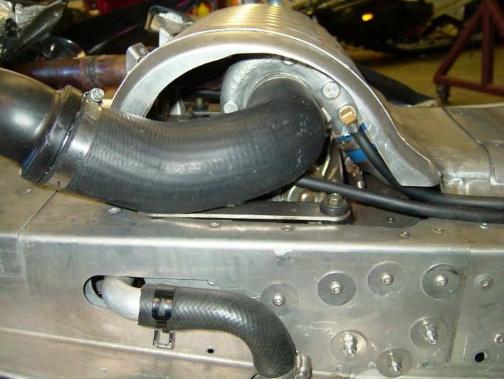

You can also build a plate to go in between the hot and cold sides of the turbo. I got the instructions from spray on this forum. I built the divider out of aluminum and it works great. The heat from the exhaust stays on that side and the colder air is on the other side. I'm sure some heat still gets through, but it has to help and it was easy to make.

Next year I will try the one K and N filter off the back right side without the box. This winter/spring we had so much dry, cold snow - it turns like sugar here in the Interior of Alaska. Folks folllowing me said that I looked like a vacum sucking up the snow with the exhaust. After five to eight miles I would open the drain value on the intercooler (I had welder on) and a least a pint would drain out. Whenever folks ask me what the heck the box was for - I tell them it holds my beer
