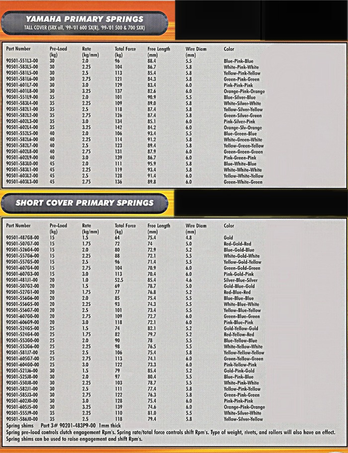

Put a stock primary spring back in it. That spring is a Yellow/Silver/Yellow. I would start there and see where your RMPs go.
The spring you have in it now will RPM much higher than the spring that should be in it. See the attachment with Yamaha spring rates.

G-W-G is way too much spring for that sled. As BYB said & i concur 100% put the stock spring back in.

I handed the Spring OEM , many turns it be 10400 to 10600
is correct?
is correct?
maxdlx
- Feb 27, 2004
- 1,832
- 92
- 1,108
- Tipton, Iowa
- 07 Apex RTX
thats about perfect
