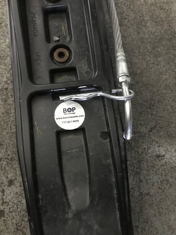

My clip idea for a retainer fared well in testing this winter. Its a simple solution that will fit most any ski. Next season I will including the clips with the mounts.
Snowman11
Exactly !! Also has the break away mount That is perfect ! Alwase good to hear from u guysMy clip idea for a retainer fared well in testing this winter. Its a simple solution that will fit most any ski. Next season I will including the clips with the mounts.
