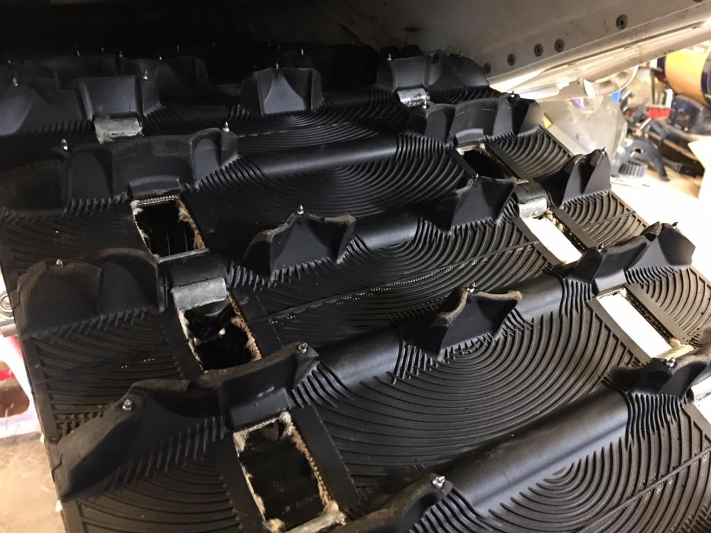

picked up 200 igrip studs at the show and how do you drill these, full depth of stud or just enough to get the stud started. Any installed pics for placement would also be helpful, thanks

I would drill the pilot hole the depth of the stud you are putting in. As far as pattern depends on the track you are putting it into.

Installing on a 137 1.25 track. You didn’t even use any tape on drill bit to know how far to drill 200 times ?
I am just that good. Lol

Thanks you. I actually used a sharpie and marked the drill so I didn’t drill to deep. Tape don’t stay put for me.

I cut the drill bit shorter with a cut off wheel so it could be chucked in the drill to the proper depth. I did a 4-4-5 studding pattern in a 129" ripsaw

My wife's Viper got 1,100 miles on it last season and I will say I was impressed with the Igrip studs. I installed them just as grizztracks did. At the end of the season I installed them on my viper and got about 250 miles on mine so far.

I have posted befor a few times. 3000 miles on them and work good for trail riding. Have tore a few out but over all holding good.
