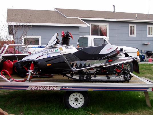

I don't know if you'll need the cables or not. I sold my brake line, throttle cable and my stock bar pad when I switched to my Fly Racing Setup. If you take the time to clean up the wiring mess by relocating the connections to under the hood and using wire loom to wrap the wiring; the final look is really nice IMHO. You can also use just the mountain pad over you stock bars with a 3" or 4" pivot riser. Here is a picture of my stock mtn bars with a 2" pivot (Sportech ABR) and 3/4" MPI block riser along with a picture with the Fly Racing setup.
