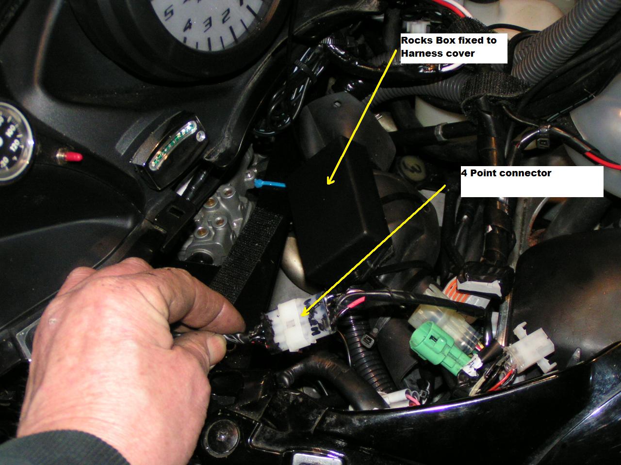

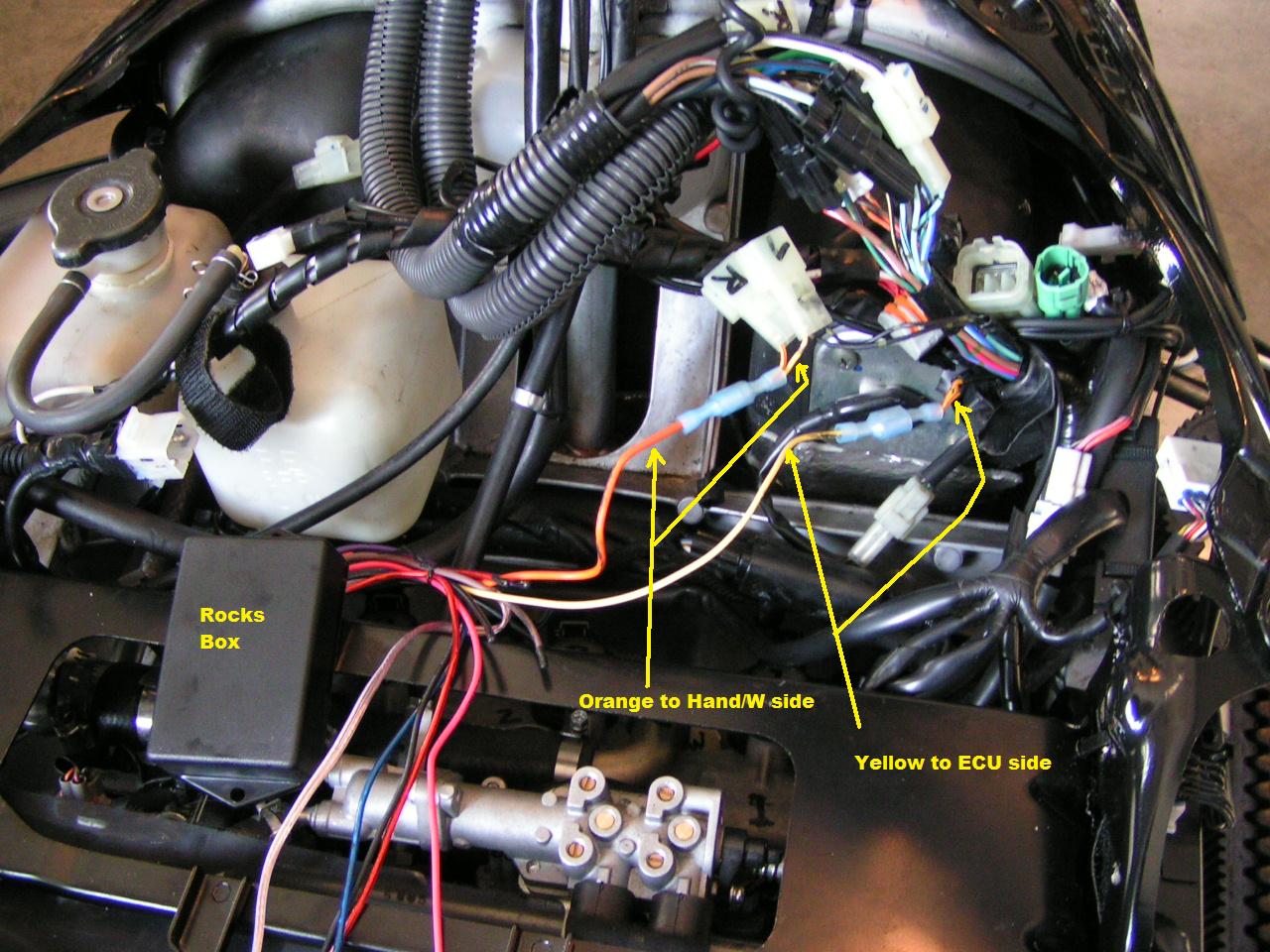

Recently installed Rocks handwarmer control box to my Apex Gt.

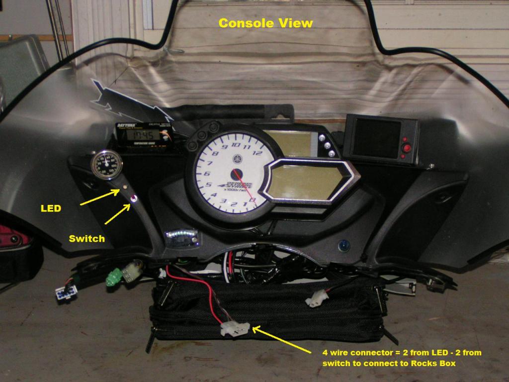

I found the installation instructions very complete but as I prefer to make things easy to remove and reassemble I wanted some way of mounting the control switch and LED to the console so that I could see what’s going on and still be able to remove headlamp assembly and support without cutting and rejoining wires for routine service etc.
I did this by using a 4 point connector (from Radio Shack) and using this to connect switch and LED to console. Here are some Pix that may assist with install on the Apex GT
Total install time – about 1.5 hours cost of connectors about $4

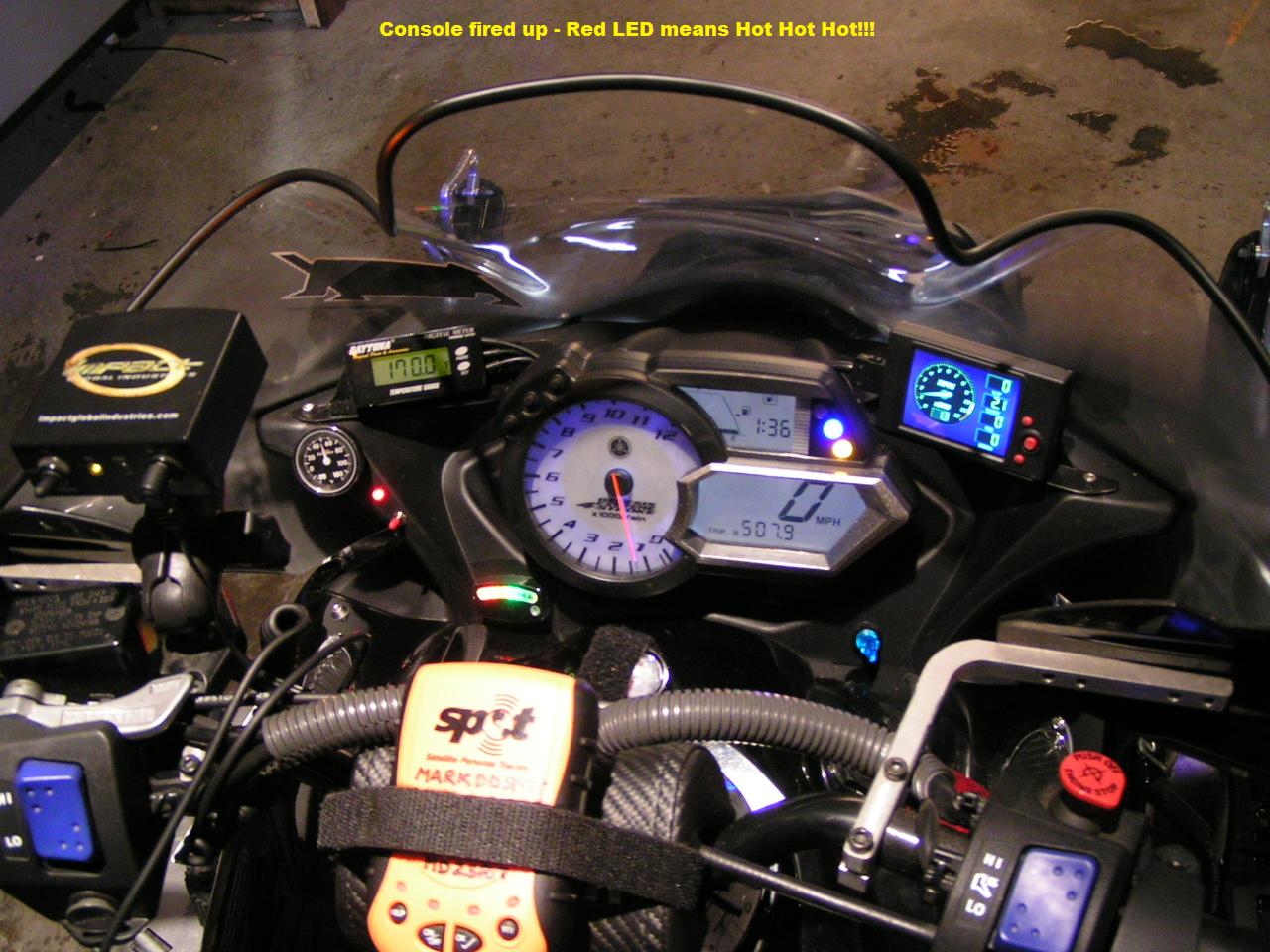

Sorry didnt see the last part about all the other "Stuff" and had to go to the pix to see what I had shown...
On the console top Right is the power commander LCD set up by Allen Ulmer....Fantastic!
Top left digital read out for water temperature also works as clock when engine is not running and tells me how much aggrevation I will get once I return home - again from Ulmer.
Far left analog Temp guage stolen from my Honda Valkyrie until I can find a digital solution...just gives me the ambient temp so I know whether my beer will be frozen or not when I get back to the truck!!! Any ideas on a digital???
LH side console mid is the Rockmeister Controller switch and LED
Below this is a digital LED Voltmeter that tells me what the ECU is putting out...and IF its putting anything out. Hate riding out into nowhere on a full battery and then have nothing to get me home!!! Automatically dims at night.
Bottom RH side switched power to sled LED lightshow!!! Dancing girls everything...
Orange box on riser protector is one of the SPOT units that can either generate an OK signal, track, send a help signal or go full 911 emergengy call up. Sends signal via sattelite regardless of where you are to any computer and cell phone with link that shows on google earth.....Guys this is fantastic for keeping the missus calm when you are out exploring someones creative trail signing at 2am in the morning. No cellphone coverage. But remember it will always tell her where the box is....not you!

Larger box mounted to LH hand protector is the new CSS trail signalling system that tell on comming sled if anyone is following.
