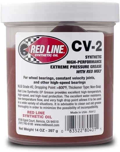

When cleaning for repacking with grease I like to spray with brake cleaner and allow to dry.. Then get a pin greaser and use a good grease and DONT put to much grease in.. Most make the mistake of over greasing and putting seal on and then the grease comes out seal as it was over filled.
- Used in a variety of applications with operating temps from -100°F to 500°F
