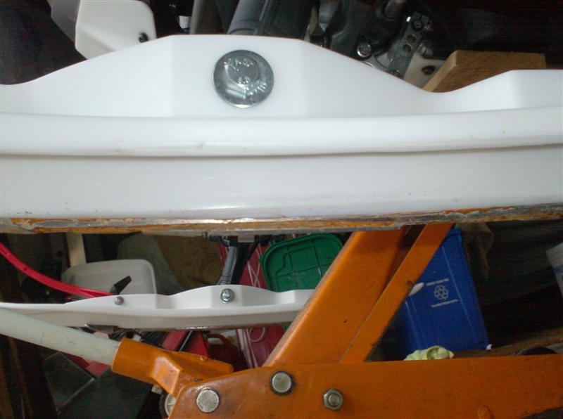

I need to jack up the front end of my Apex so I can take the skis off to install my Bergstrom triples. I don't have any fancy sled lift.
Can I use a standard car jack somewhere up front safely. I would hate to punch a hole in something with the weight of the sled. I tried lifting it up to place on some blocks and it's heavier than I remember.

put a piece of 2x4 across the belly pan between the skis about 8-12 inches long, put the floor jack in the center and both skis will lift easily.

snowxwi said:I need to jack up the front end of my Apex so I can take the skis off to install my Bergstrom triples. I don't have any fancy sled lift.
Can I use a standard car jack somewhere up front safely. I would hate to punch a hole in something with the weight of the sled. I tried lifting it up to place on some blocks and it's heavier than I remember.![]()
By standard car jack, do you mean a floor jack?
That is what I use but I also have a flat piece of fence board that I use on top of the jack and it goes the full width of the belly pan to help distribute the weight.
I raise it near the back of the belly pan just in front of the heat exchanger as it seems like the most sturdiest/robust place to do so.
Good luck.
(Edit:You can my piece of wood in this pic and the location)

Yes, I meant floor jack. This is exactly what I wanted to know. Thanks guys.
snowxwi
Thanks for the tips. I was able to get my skis off without an issue using this method and the underside seems to be unharmed.
