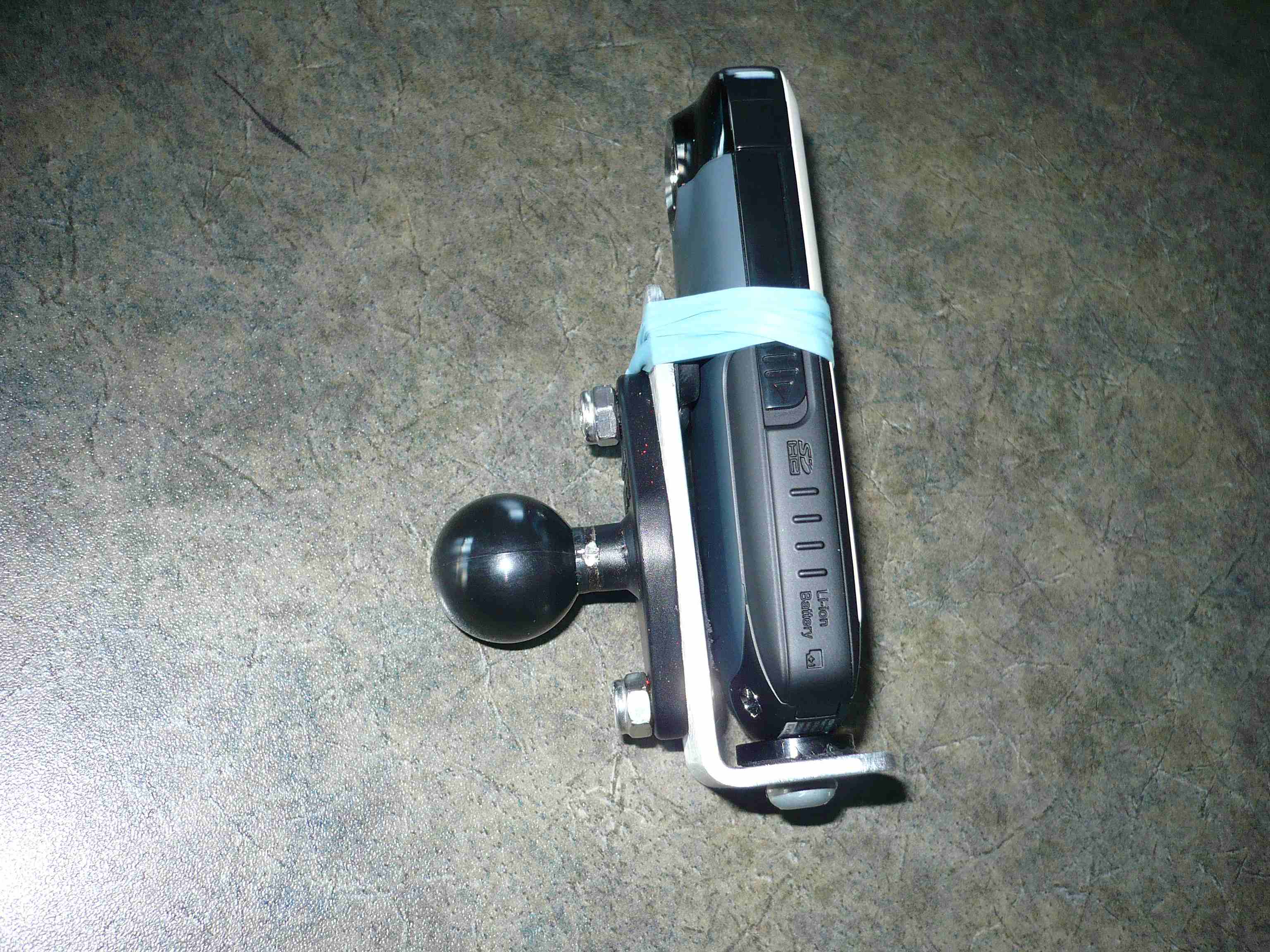

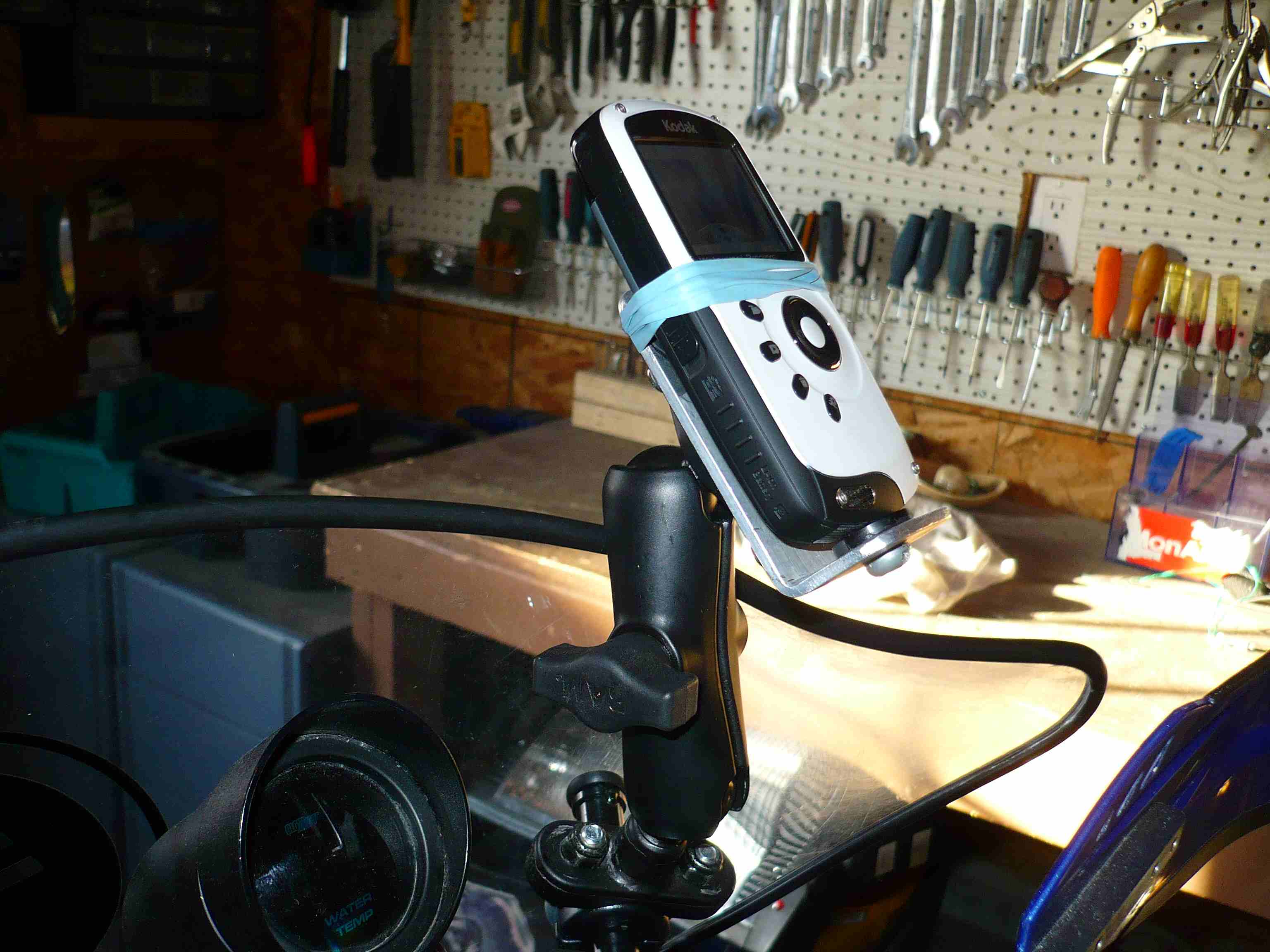

I purchased a Kodak PlaySport video camera for hunting and of course snowmobiling. The plastic tripod mount is a weak spot on the camera (if you check out other forums) so I made a mount that attaches to the camera in 2 places and provides more stability.

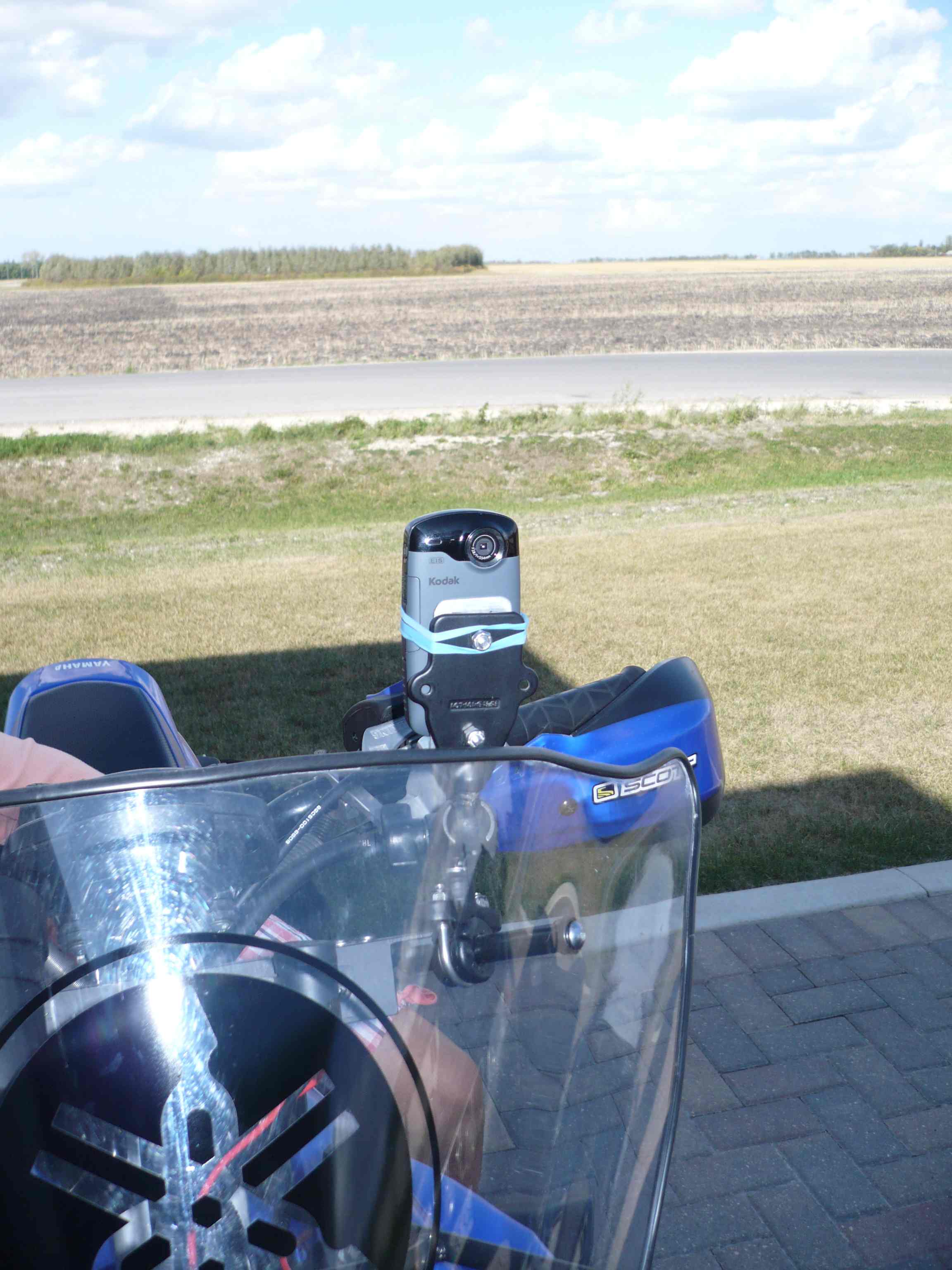

I attached a Ram Mount to a piece of aluminum. The camera attaches to the aluminum with a screw thru the tripod mount and has an elastic (looking for a better solution) to hold it to the aluminum near the top of the camera. I may also install it on the front bumper - should get some nice video.
I used it on my bike and it is very stable and easy to adjust. Can't wait for the snow.

How's it work at high speed.

It should not be a problem - there are youtube videos of the Playsport on motorcycles just using the tripod mount.

I made a change to the Playsport mount. It was too shaky with the ball on the bottom. This mount is much more stable. Hope to have it out for a ride soon.
I really like the fact that has a screen to show what you are filming.My old GoPro missed alot of footage because I never knew for sure whether it was aimed right until I downloaded it.Another issue is trying to turn it on especially mounted on helmet which does seem to work best.A remote bar mounted with a light that indicates unit is filming would be really nice.Cubby yours looks like it should be accessible while riding even.You will know its on and aimed.Nice job!

cannondale27 said:I really like the fact that has a screen to show what you are filming.My old GoPro missed alot of footage because I never knew for sure whether it was aimed right until I downloaded it.Another issue is trying to turn it on especially mounted on helmet which does seem to work best.A remote bar mounted with a light that indicates unit is filming would be really nice.Cubby yours looks like it should be accessible while riding even.You will know its on and aimed.Nice job!
Yes, same here. I will be buying the LCD screen for the gopro.
Cubby, I like the set up!
