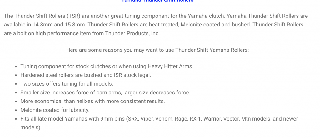

Stock 14.5mm rollers in my primary are finished after 2k miles. Have a set of 16 mm sitting in toolbox. Thinking bigger rollers may be more durable but don't want to sacrifice performance.
Ive heard mixed opinions....Some say bigger rollers slow shift and apply less belt grabbing force while others say roller size only raises rpm engagement.
For 2019 Yamaha went from 14.5 to 14.8. What are disadvantages of running big rollers?
Well, did 100 miles the other night with 16mm rollers and did not notice any changes in runnability. Perhaps might be tick slower, but never did any tests to confirm or deny. I'll run them for trail rides and put the 14.5s when racing.

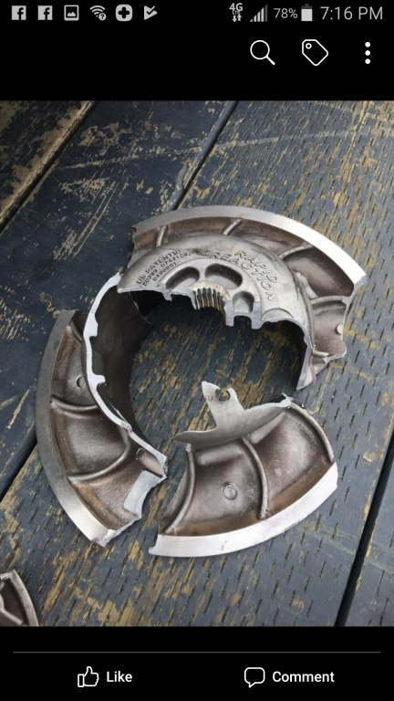

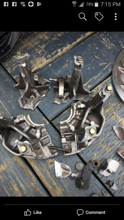

@ROCKERDANView attachment 143442 View attachment 143443 View attachment 143444the team clutches have been exploding too. They pop up on some of the Facebook sw/tcat groups here and there but usually get taken down quickly where the exploded yamaha clutches are allowed to stay posted.

Id prefer to see the link and thread...as to the "whole story" there. Can you link please?
As I said, I read HCS daily too, and still have yet to see the masses of clutch/belt threads that are a daily occurrence here.
With big power everything can/will eventually fail, but so far it seems the most are over here.

Yes maybe the team may be a cheaper primary than those other clutches(tap and stm) but with wider belt,need to match secondary,more pricy cat belts,and still no guarantee belts will last any longer.My stock primary rollers were hammered out quickly after installing the Hurricane Jukebox. I was way off initially on clutching(TP Orange and reverse angle helix) like many of us were early on which sure didnt help the rollers.
I installed the TP rollers, tad larger OD(14.8mm) due to thicker bushings....ran them all winter and look ok still. Will see how long they hold up.
Seems we need to find a decent primary clutch altogether. the TEAM can be the most cost effective primary to go to as its far less then a TAPP or others. Also allows for wide belts. Just not certain they hold up over time/miles? I think they are doing better then ours though.

Looks like a '17 TEAM as they cracked similarly.I just stumbled across that post is all...
New updated 998 TEAMs I have yet to see one go....not to say they wont at 290hp but sure seem tougher then YAM primary.....
