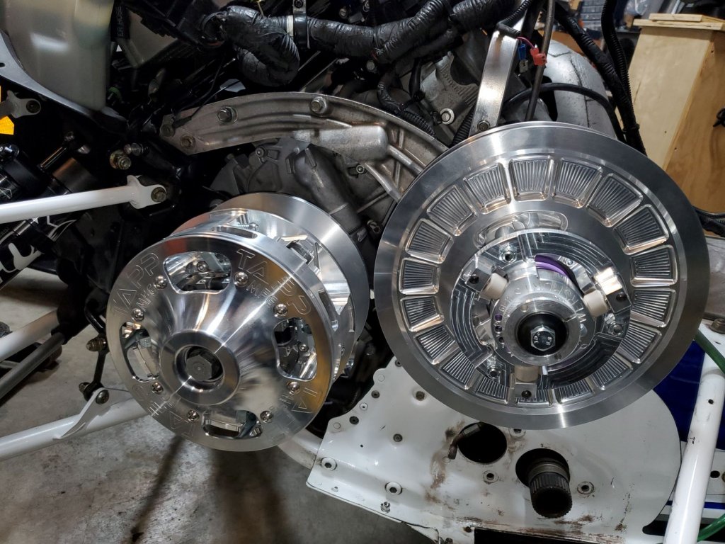

Set up?View attachment 161369 STM 11.25 secondary and TAPP Primary. On my 240 turbo viper.

Primary was set up by Dave from Tapp so I'm not sure what's in there. Clickers are so nice for fine tuning. He set it up for my 240 horsepower. Secondary, running a 39/43 helix with a Green spring from Hurricane set at 70. Pulling 8950-9050 at full shift and 8900 at full throttle. Clutches Run so much cooler than my yammy clutches. Gears are 22/41. Top end of 126 mph.
Great back shift and NO RATTLE....

39/43 reverse helix? Or is it a 43-39?Secondary, running a 39/43 helix with a Green spring from Hurricane set at 70

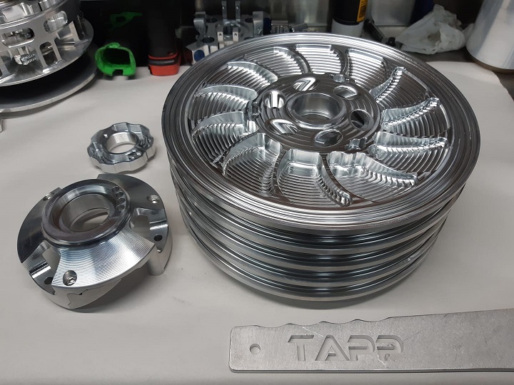

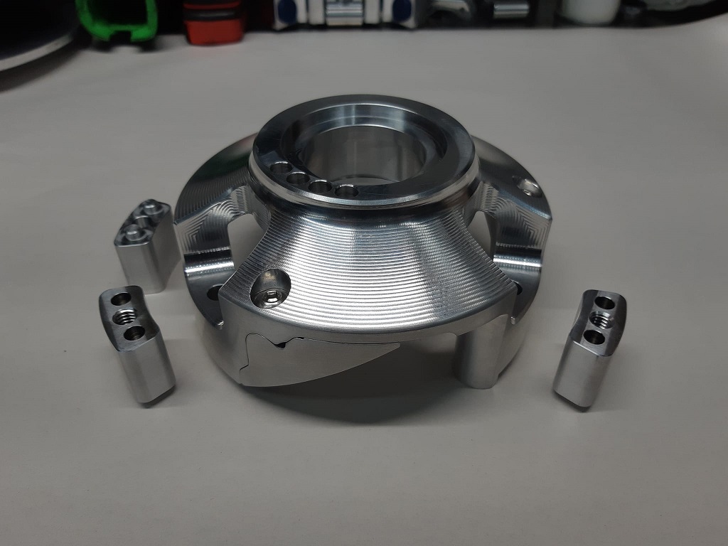

Tapp clutch new secondary coming soon

Pretty piece.

I can just imagine how many thousands of lines of G-code hsm works spit out to mill those sheaves lol. Very very prettyTapp clutch new secondary coming soon
