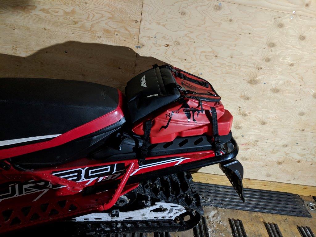

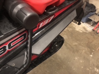

The tunnel will bend if ridden hard with the larger gas can towards the back. Don’t ask me how I know...
You can easily build a aluminum plate like I did and fit two fuel cans for Torco back to back, one large Linq stackable gas can with an optional medium bag on top as well as a second linq bag on the back with an extended custom plate.
It works awesome.
On really long trips I can even add the Yamaha saddle bags to the sides of the seat for even more storage.
Sorry for the crappy photo... I will take another and post it when I get a chance.
Cheers
It works awesome.
Cheers View attachment 151404View attachment 151405

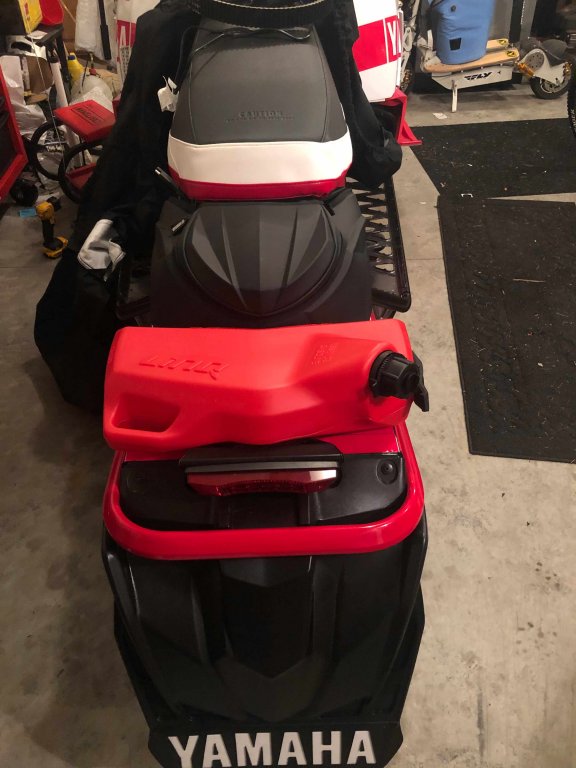

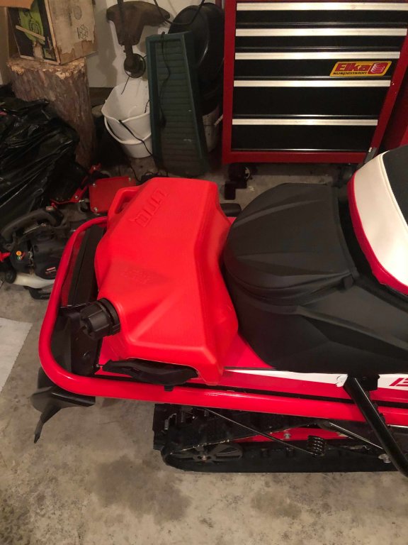

I think the tunnel on a 137 is 2 - 3" shorter on a Sidewinder vs. the Viper tunnel. Not sure why they shortened it. For me, this caused a lot of issues as well when I was in search for a fuel tank and not wanting to have to remove the new Medium tunnel bag. I absolutely love the bag and how much room is in it. I finally found a solution that gets me 1 gallon of fuel and it fits like a glove without any room to spare while keeping the medium tunnel bag. Linq just release a new 1 gallon fuel caddy that fits perfect
View attachment 151358 View attachment 151358 View attachment 151359 View attachment 151360
Did you use the whiteout technology brackets to mount to?
putz21
- Apr 15, 2013
- 681
- 544
- 1,208
- Tomahawk, WI
- '25 Sidewinder XTX LE w/EPS
'23 Sidewinder LTX LE w/EPS
Yes I did.
