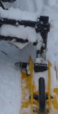

Spend a little time and make some that won't snap off if you use reverse, bolt them on and forget them. Mine are a little short, basically they are "snow throwers". I'm gonna try welding a stud on to them, and maybe a little "wing" to toss the snow towards the sled more
