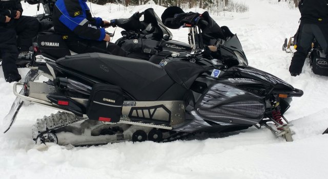

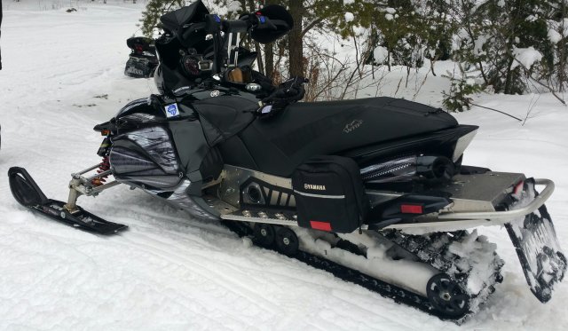

Ok I've done a lot of research on here, and other sites. I saw one modified the nytro fuel caddies, and yes it works. Cut the 90 degree bend off on the bracket. Mount through the tunnel with 4 bolts with washers, and nylocks and it fits perfect oddly enough still works with the yamaha accessory saddle bags in this position for backpack trips. Doesn't get in the way of riding, no worries about getting rear ended like a rotopax, and no worries of exhaust issues . 20150103_131056-1.jpg20150103_131056-1.jpg20150103_124413-1.jpg20150103_124356-1.jpg
Nice sled. You just gave me an idea as to where to mount my gas cans, same idea but i'm going to make a mount myself.IMG_20140216_135454.jpg
I changed my mind, i'm going to get the nytro caddy bags and modify like you did, looks like they are mean't to be there.

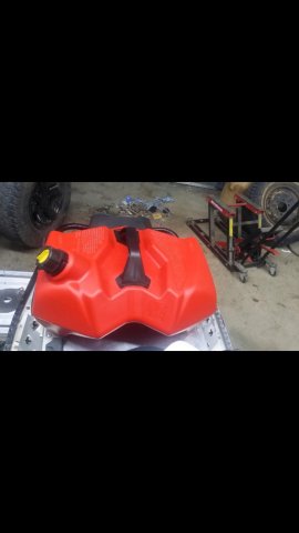

Linq system gas can and the linq system from brp also has luggage containers and a lot more to add on
