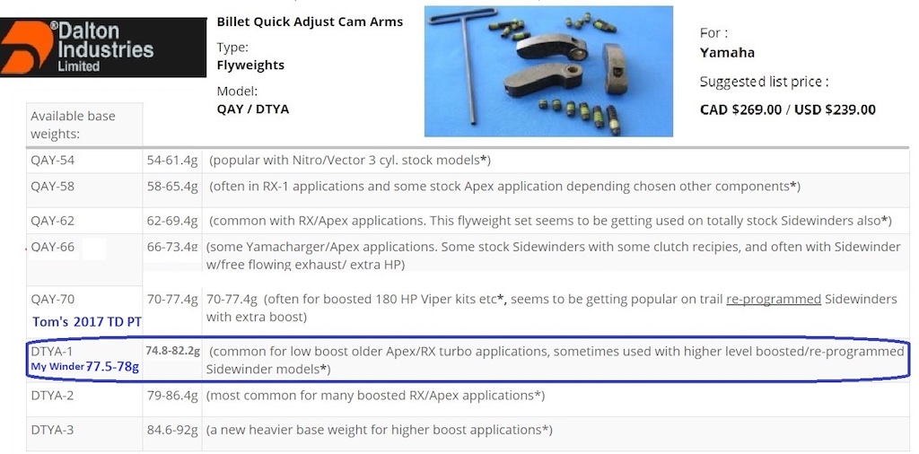

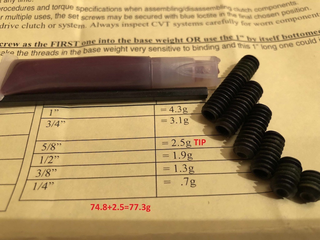

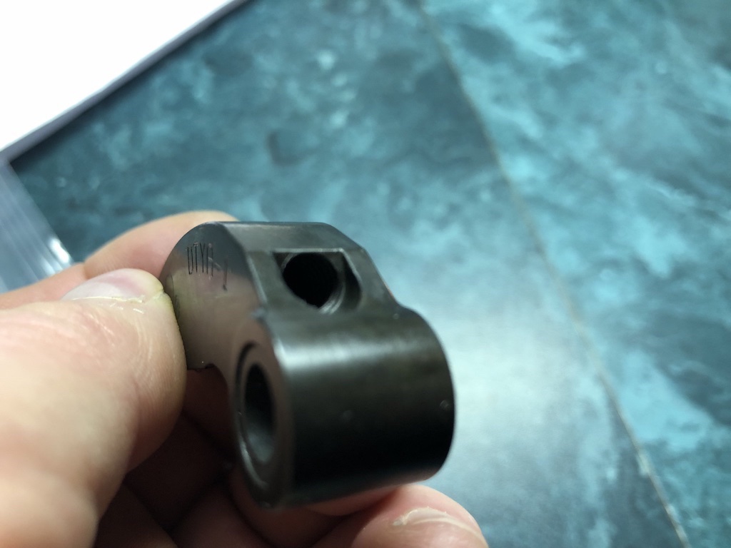

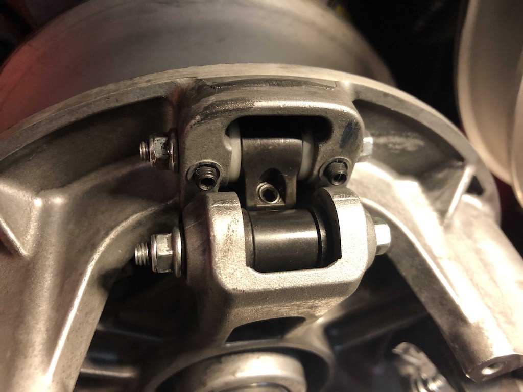

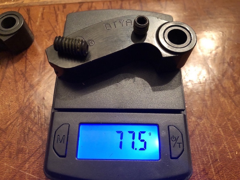

If you have stock muffler, then you would want stock muffler tunes.....if you plan to run an aftermarket muffler or a modded stock muffler, then you can run the regular jukebox of tunes like I have.I just purchased the hurricane 240hp, 270hp, and 290hp bundle and was wondering if the Dalton weights would be a better match than the stm weights that come with the kit? also very curious if the stock muffler bundle 225hp, 240hp, and 270hp would suit me better for I like to set and forget and I am guessing the latter wouldn't require any adjustments to the clutching to flip between all three maps or would it?
As Mike mentioned, the STMs are not as easy to add/remove weight. With the Daltons, you simply add/remove small allen key slugs anytime, no need to remove clutch or anything, can even be done trailside if you like. This is likely why most of us run Daltons.
What most guys will end up doing is setting there RPMS to revv a tad high on the tune you run most often. Then the lower tune will rev a tad low but good for touring then. Really depends which tunes you go with.
Pics below of my dalton adjustable(Dtya-1), you can see how easy to adjust.

Thanks for all the great information on the clutches. I was leaning toward the Dalton weights for the reason you mentioned about how easy they are to adjust. I figure I would mostly run between the 240 and 270 tune and on occasion run the 290 ( lakes or what not). Dan what would you run for weights to be able to switch between 240 and 270 without having to add more weight. the reason I ask is if you cant actually run at least two maps on the same weight then why would the flash to pass button be of any use? I spoke with dave and he did tell me the stm weights would work on the lower tunes but would need more weight in order to run the 290 map. Would this be the same for the Dalton weights you have in yours? Thanks for any help. I have learned so much from all those on this great forum
It depends on the tunes you have.....with my aftermarket muffler/Hurricane tunes(240r/270r/290r) I run these DTYA-1s as shown in pics above. I like them overall, set at 77.3g per arm. Using one 2.5g slug tightened all the way down into tip.(not like the last pic where I was testing slug in Heel) If you have stock muffler tunes those may need a lighter weight like the QAY70. There is some overlap in the weights between the 70s and dtya-1.
With 77.3g and my bk/red(48/12okg)spring and two glide washers in Primary, and then a B/O in secondary at 6/1 settings....I will rev a max rpms of 9000-9100 on 270 map. 240 map revs approx 8550-8600, and while I rarely run the 290 map, it is only a tad higher rpm then the 270. I find the 270 map to be used 90% of time. This is for overall everyday trail riding. The reason I like it here, is when you spin it 9000k or so, this seems to be the sweet spot for corner to corner SNAP, and serious nose lifting off knolls power. Now I realize the best rpm is closer to 8800-8900 on the dyno, and Dave has told me this many times.
So, if you are talking speed running, and holding it WOT all the time, then of course you want to dial the weights in for that 8800 range at whichever map you run most. But remember if you are running WOT for any sort of distance, you will NEED the fuel for that type of riding. If I am gonna go out and radar run, or lake race or just do speed runs...I would certainly dial in my 290 map(or the most powerful map you have) for 8800 or so(maybe need 82g or so?) and then fuel up with some 93 octane or add some Lucas octane booster or torco additive, or some race fuel. My buds sled pushes 31psi and never sees any knock lite flicker at all, its cause he runs C16 exclusively for fuel. He does not trail ride.
Hopefully that gives you some sorta of idea where to go....Helix depends on tune, and if you run tight trails or big wide open ones, and gearing.....most here will tell you to stick to stock gearing, as many of us who went to 22 gear found its tough on belt life.
Dan

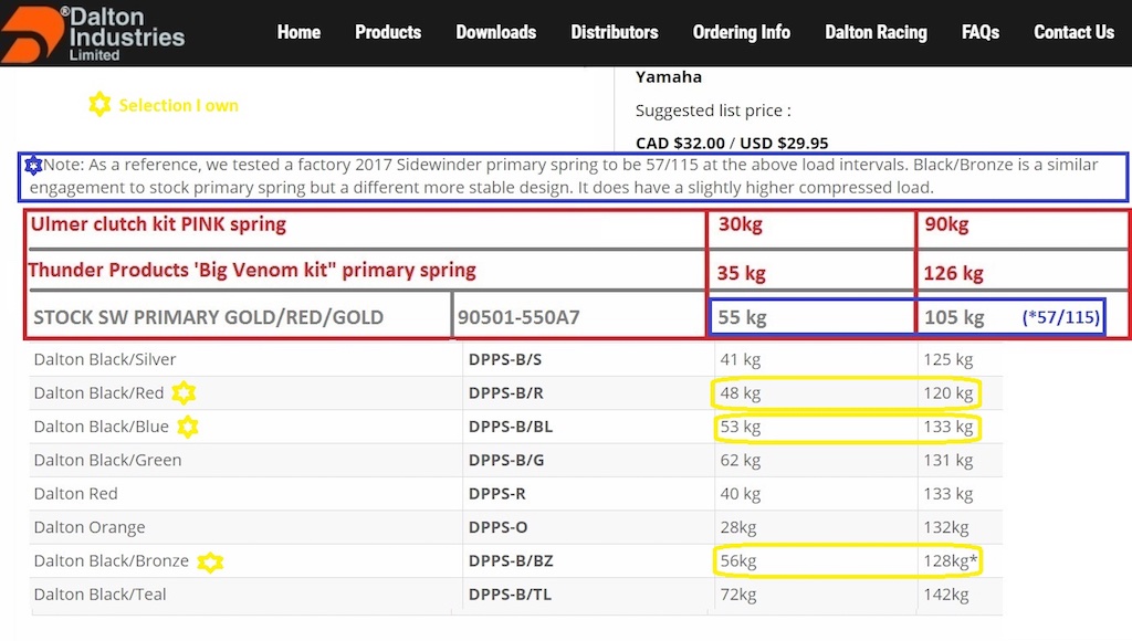

I would not run green primary....its a high engagement spring, I did not like it...Glide washers add a tad to these in engagement and help prevent coil bind in primary. I ran the bk/blue which was fine, and now run the bk/red. Lower the better IMO. Sounds like same tunes I have, so DTYa1s around 77 to 80g depending how you want to rev.

That sounds like the blk/red would be a spring I will try instead of the blk/green. I will be using the glide washers as well. Dan didn't you sell your 39/35 helix awhile back? Have you put any miles on the new 37/35 yet? I have the hole shot helix from thunder but was told it may not work so well on the 270 tune. so if I ride tight trails and corner to corner with some straight a ways I should run between 37 to 41?I would not run green primary....its a high engagement spring, I did not like it...Glide washers add a tad to these in engagement and help prevent coil bind in primary. I ran the bk/blue which was fine, and now run the bk/red. Lower the better IMO. Sounds like same tunes I have, so DTYa1s around 77 to 80g depending how you want to rev.
Stock 35 helix will work but may max out rpms quickly on 270 quick spool map. Many like 41/35, and I liked my 39/35, and now testing a 37/35 for tight trails. 270 map can easily pull the 41/35 for great ET. I want least slip of belt and good corner to corner rpm. All depends on your riding style and area, and stock gears or not.
