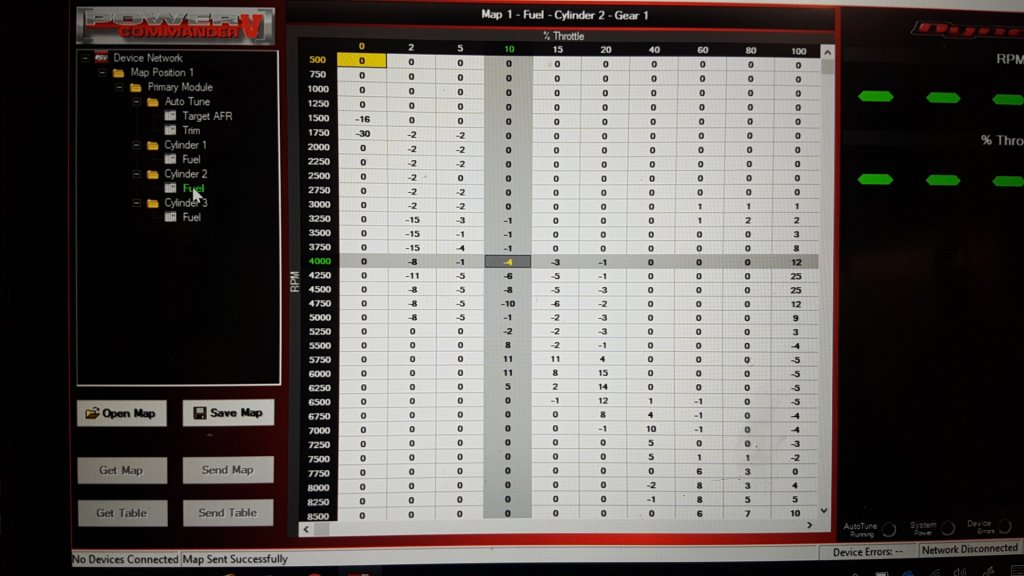

Can you screenshot the maps and post them?
My_nanc
I can do that tomorrow yep.
My_nanc
Here are the 3 maps, idles way better and mid to top pulls hard now.... was way rich at bottom end also on all cylinders. I will know about the cold start within a week or so. But when its cold in shop it fires up instantly.
That is really cool! Thank You. Well done!Here are the 3 maps, idles way better and mid to top pulls hard now.... was way rich at bottom end also on all cylinders. I will know about the cold start within a week or so. But when its cold in shop it fires up instantly.
