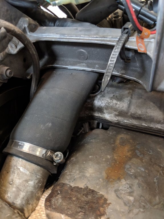

  7. lakercr
    lakercr Tech Advisor Tech Advisor Lifetime VIP Member VIP Member
    Messages:
    2,274
    Location:
    Winnipeg, Manitoba
    Yup, that looks fine

  8. hlmrx1
    hlmrx1 TY 4 Stroke Guru
    Messages:
    976
    Location:
    Manitoba
    Yep, mine is like that also, like lakercr said, they are pre-formed to fit there.

    Thanks gents for the help. Just seemed like a very restricting way of doing it, but what do I know haha!
  11. 87gtNOS
    87gtNOS VIP Member VIP Member
    Messages:
    1,866
    Location:
    Toronto
    Country:
    Canada
    Snowmobile:
    12 Apex XTX MCX powered
    why not notch the frame right there?
