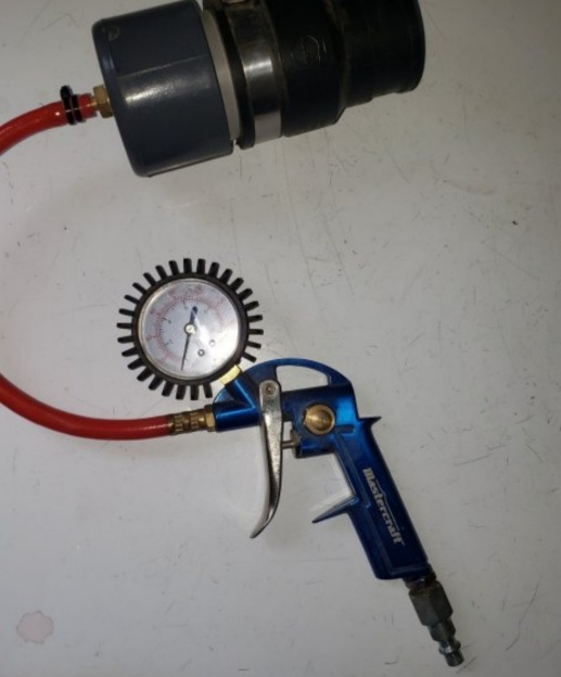

Where/how do you connect this to test for leaks?You can also buy one already made if you want. https://www.amazon.com/gp/product/B0825W6Z85/ref=ppx_yo_dt_b_search_asin_title?ie=UTF8&psc=1

Big_Phil
- Feb 5, 2014
- 1,177
- Wasaga Beach, Ontario
- Sidewinder RTX LE
Charge tube right off the turbo.Where/how do you connect this to test for leaks?
Turboflash
- Mar 18, 2019
- 2,133
- Southern MN
- '17 ZR9000 Ltd. PEFI Stg 3R
Make sure you have help. Never allow engine to rotate backwards (compared to normal rotation on clutch side which is counter clockwise). As you apply air pressure to tester, air pressure will cause engine to want to turn. Make sure it does not turn backwards.

Can I ask what is the best and safest way to prevent the engine from spinning ?
yamamarc
- Sep 29, 2013
- 3,057
- Massey Ontario
- 2019 zr9000 Ltd
I think I will order one of these after I get the size needed.. not saving much making your own by the looks of it…. Thank You for the link
Arounf 15$Canadian at most to make your own and very simple
Simplespeed
- Jan 8, 2022
- 261
- Age
- 64
Is that a old paint gun you used to make that ?? Nice… My problem is Iam 230 miles from my home garage where making one no problem, and a hour from a town that would have supplies needed to fab one up so at $36.00 no biggie to order …. Thank You for sharing a pic of yours….
