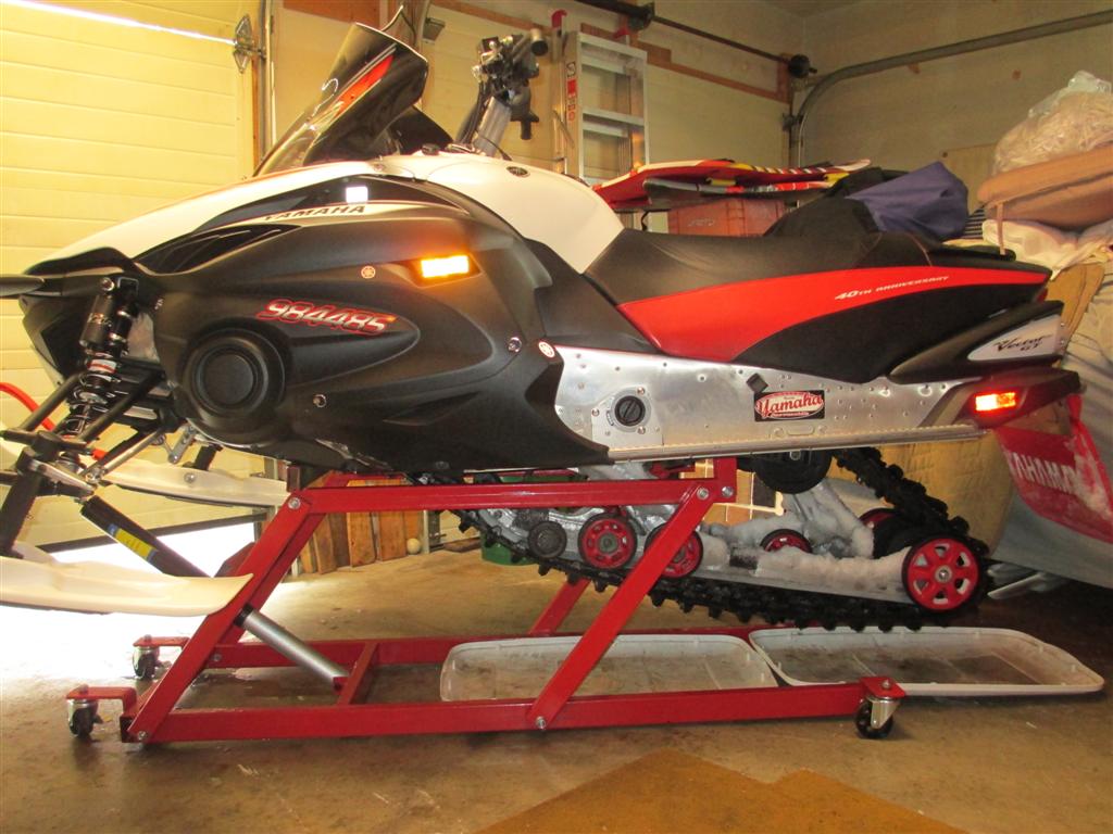

Older post but I fog mine every spring after a good dose of Seafoam is run through the system. Once the fog causes the engine to stall, I syphon out as much gas as possible and throw it in my truck. The rest of the sled is summerized (greased, oil/filter change, waxed, etc) then put on my lift and forgotten about until the fall.
Once fall arrives, I purchase new gas, apply pressure on the vent tube and it fires right up. No need to fire it up over the summer once fogged and syphoned. It works for me and has for years, but each to their own.
