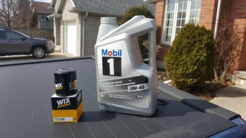

stomper
that wix number is for the viper oil filterHere is my oil change kit.

It's on the box under the filter. Zoom it in.,

I have been using Mobile 1 0W 40 since my first oil change. I use a Wix 51356 filter.
It is the same as the 51358 listed above except it is slightly larger. I believe about 0.4 inch longer. Yes it will fit. It’s the same filter that is on my Mazdaspeed Miata. I went to the larger filter so I could have less inventory. I usually buy my filters by the case.
