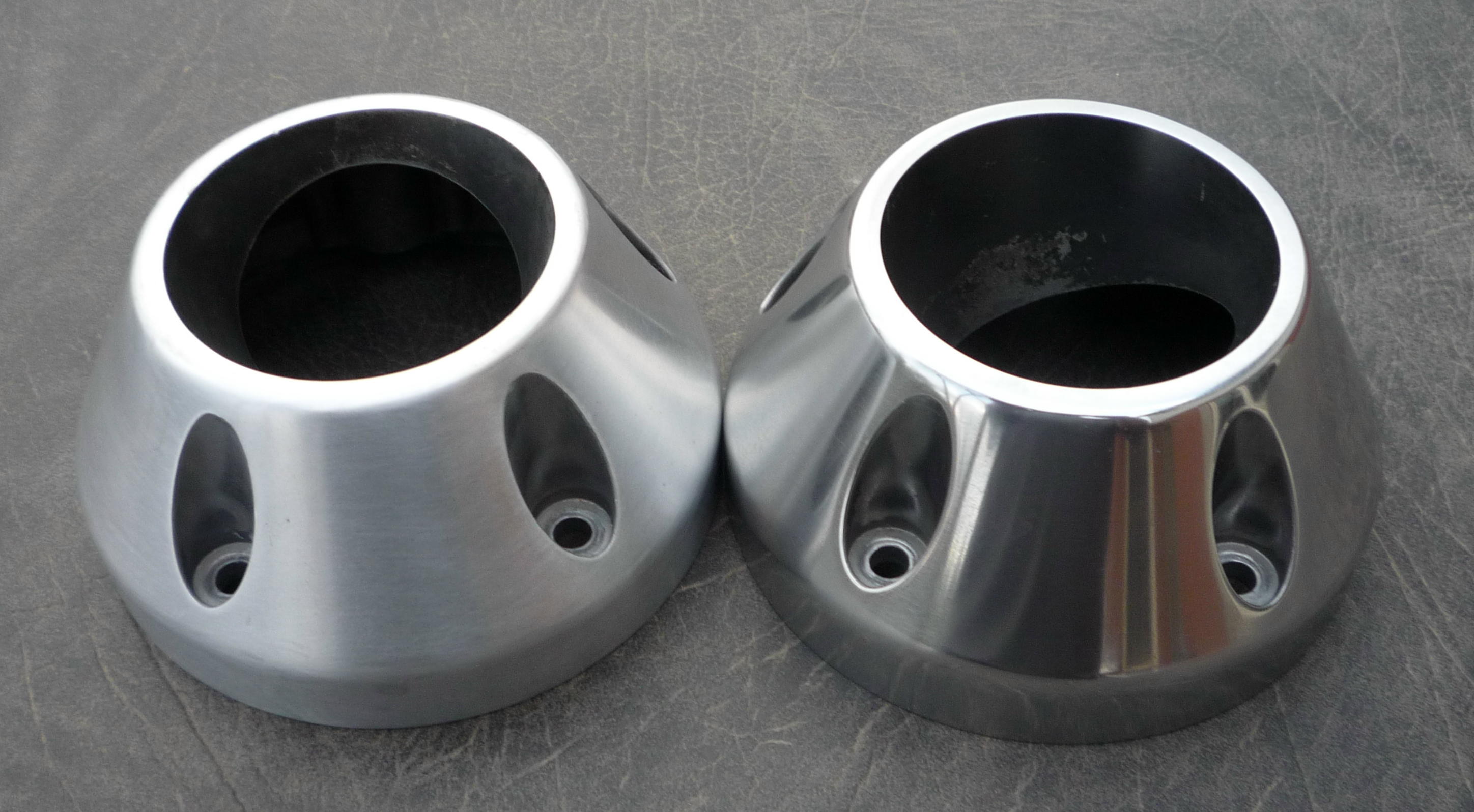

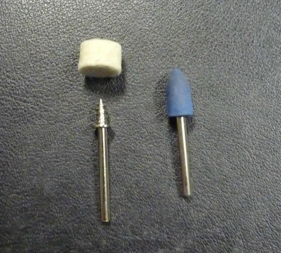

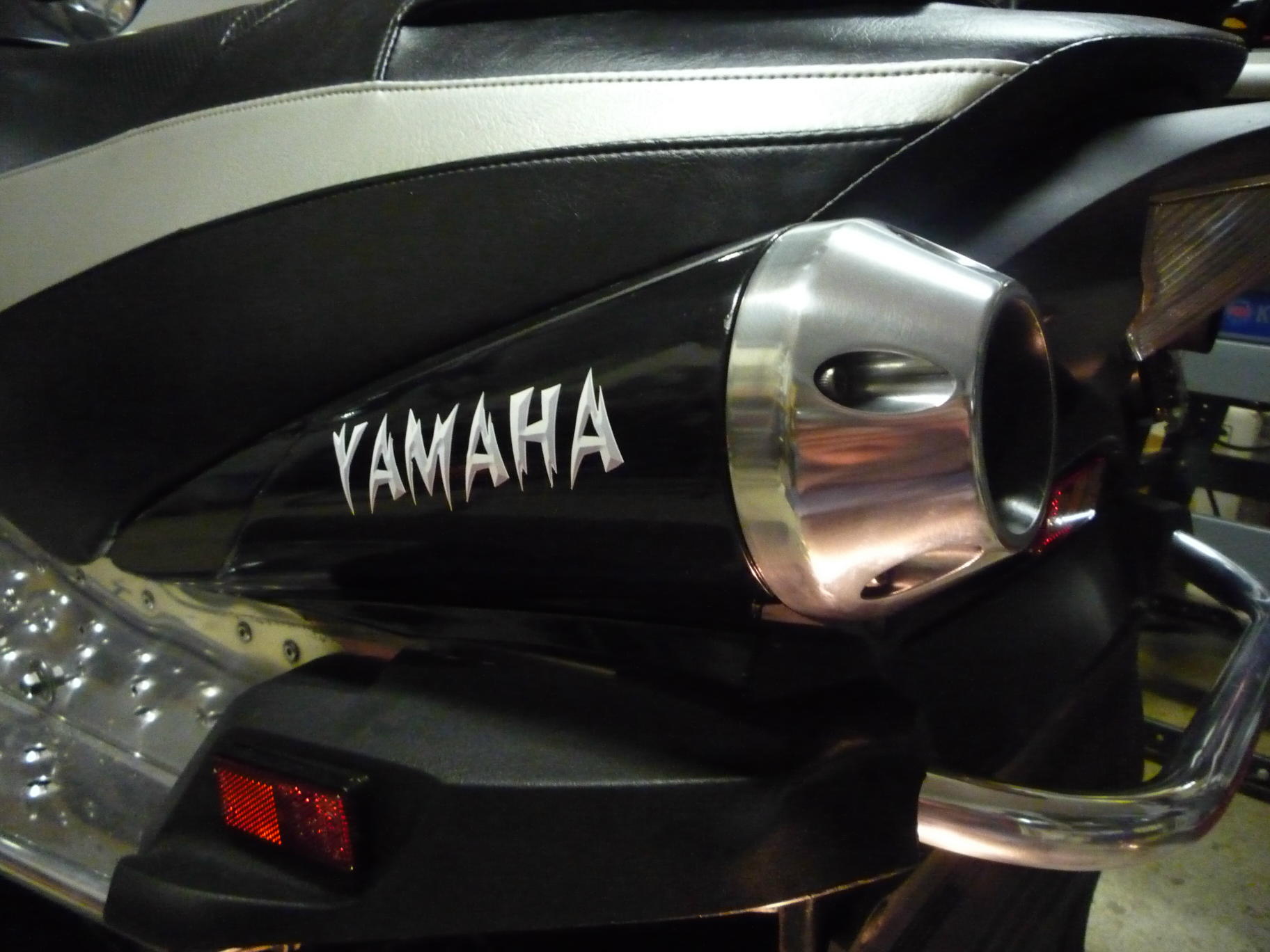

Just polished the exhaust cones and it was a little harder than the tunnel because you have to sand out the lathe marks and scratches first but I think it was worth the effort. Also found out what some of the weird bits that I've never used in my Dremel kit are for.
