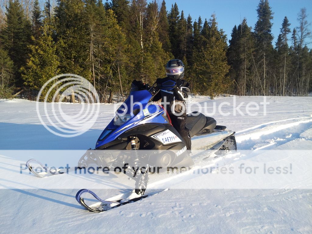

Here is my navigator. 10 years old and he still insists on sitting in front of me when we ride. I don't mind, that way he can learn everything that goes on. The funny thing was that his first ride after I put on the new arms he noticed as soon as we left the trail. He really thinks that it is fun to tip it on its side to corner. He kept bugging me to do donut after donut. A monster is born.
