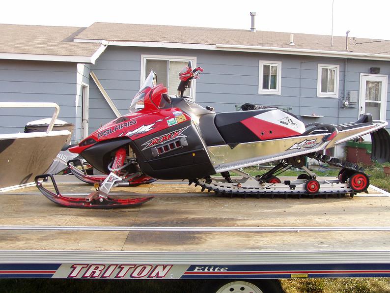

One thing to consider here when looking at track l;egth is the fact that Yamaha doesn't seen to put as much track to the ground. A Yamaha 162" is more like a 151 on the other OEM sleds. Here's pictures to show you what I mean. Based from this info; I'd say the Yamaha 151" tracks were comparable to a 144 from another OEM sled.
I happen to have my old Camoplast Challenger 2.52" pitch 151" track with 2" paddles in the garage also if your interested. It's in great shape but won't work with extrovert drivers (every 3rd window is closed). I was saving it for a spare for the wife's sled but with 3 seasons now her track is still fine.
