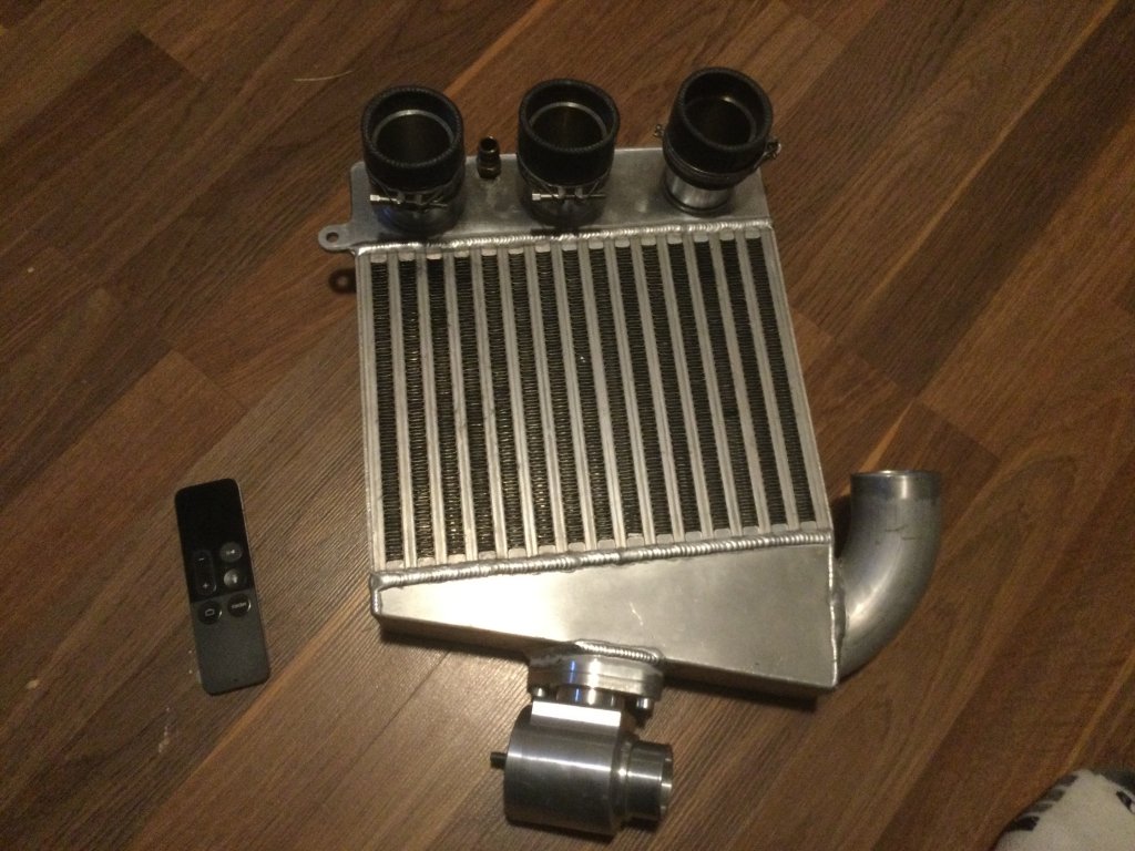

Finally found an intercooler for my 15 Viper XTX and plan is headshim and Studs next year but want to install intercooler and quick spool waste gate this year…Question I have is the intercooler comes with the high flow billet blowoff valve, and my understanding is there is a already a blowoff valve on the mpi turbo set up…Do I need to block anything off?
Set up…Dealer installed MPI turbo, 2.5 inch DD can, PC 5 pti, pod 300, autotune, hurricane map, 6 lbs of boost at sea level.
Thanks in advance

Do you have any pictures?

You currently have a Turbo with the other style non cooled air box for the turbo?

Yes the Yamaha MPI low altitude kit that was a dealer add on with the above mentioned changes. I also have the bigger injectors.

All the hookups should be the same and really nothing will need to be capped from what I can remember when I have converted them.

You will use both the BOV on the turbo and the intercooler, simply tee into the vacuum line currently going to the turbo BOV and run a line to the intercooler BOV as well.

I have never seen them run both, thanks for the input.
