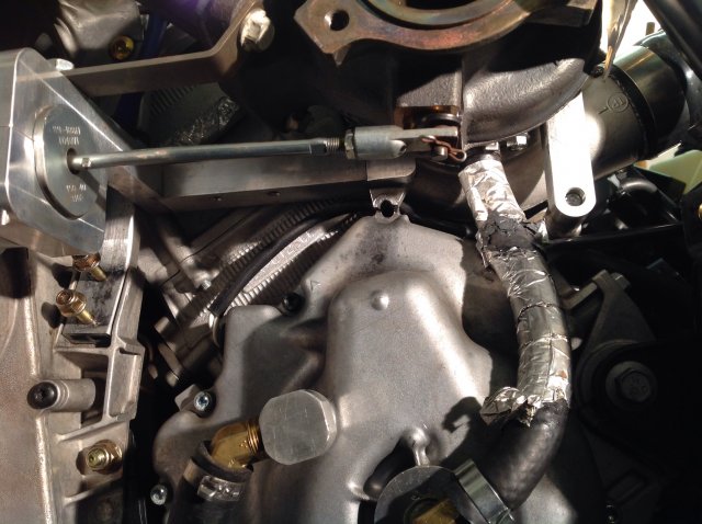

Hi guys ! Now I am really disapointed! I was TRYING to Set or alling my turbo kit for exhaust and compressor clearance as told by MPI to my dealer and look what I found BEHIND the oem frame bracket.............3
As you can see the lower rear mount bracket Is broke really badly.... And I think its been a wild since it's been broke !!!!! The bolt has eating ALL and even more of tread in the engine casing!!! NOT FUNNY at all. This part of the bracket is screwed on the flywheel cover direct in the based casting......
I wonder if i am the only " lucky one" ho have wich I call a MAJOR problem??????????
I know its not easy to look for this but whitout removing the oem FRAME parts but you can see it a bit with a flashlight

They will be able to Helicoil the case easy enough. Might have to redesign that bracket to catch more than one of those bolts. Were any other mount bolts loose?

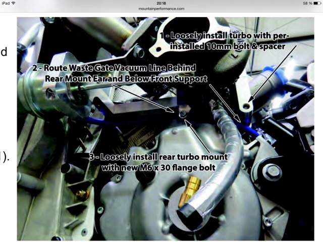

Checked ours and they are fine. Sorry yours broke but good thing you checked yours so things didn't get worse. I am pretty sure I know why yours broke let me try and explain. The main turbo mount has a big M10x60 flange bolt that carriers most of the weight of the turbo(front mount). On that M10x60 bolt there is a aluminum spacer between the turbo mount and the mounting ear on the engine. That spacer has a 15 degree angle cut on one side. If that spacer was not originally rotated correctly so the 15 degree surface mates up with the engine mounting tab it would put a tremendous binding stress on the rear mount that broke on your sled once everything it tightened down. That rear mount doesn't carry much weight it's mostly there to be second mounting point so the turbo mount stays level and in place. That spacer is covered in the MPI manual on steps 66 - 68. Also looks as if your turbos oil return line was cut way to short by the installer and is rubbing a hole in the hose where its routed behind the OEM side support bar. I believe Yamaha has machined that front mounting tab flat on the new 16 engines. Maybe MPI can chime in on Monday.
http://mountainperformance.com/Files/Download/mtv-0500 viper 190 r2.0.pdf

Yep what he said. Loosen that big bolt and rotate that angle cut bushing until it fits the best before final tightening.

Hi guys ! Now I am really disapointed! I was TRYING to Set or alling my turbo kit for exhaust and compressor clearance as told by MPI to my dealer and look what I found BEHIND the oem frame bracket.............3View attachment 112065View attachment 112066View attachment 112067View attachment 112067
View attachment 112063 View attachment 112068

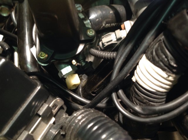

I also have problem whit thermosensor plug,its broke
take a look at yours it seems at a bad place!. How did you place yours?????
take a look at yours it seems at a bad place!. How did you place yours?????View attachment 113092

On our install I put the thermostat housing slightly tilted to get it to clear the hood. Did yours touch the hood and bounce into that sensor?
Just another Tip on the thermostat housing. When we did our 2 installs the final location of the housing can be moved quite a bit if all the hoses are loose. Then move around so it ends up in a safe place so that wire doesn't get broke or pinched on the side of the housing. You can even trim 1/2 to 1/4 inch off the hose to allow for extra clearance with that plug and the frame of the sled. Once your happy tighten all the clamps down. As stingray said your going to need to tilt it a bit, that's normal.
