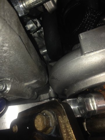

During the reinstall of the mounts and aligning the turbo I had an issue with the turbo touching the motor slightly and also there was some strain being put on the mounts. Both problems stemmed from the alignment and I'm hoping they also caused my mount to break.

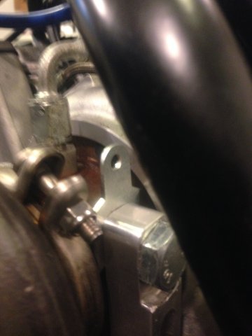

After many attempts in the tightening procedure I had to figure out another fix. The issue was the front bracket was not sitting just perfect, for whatever reason. Once this turbo is attached to the header and all the mounts are loose in place there is no "play". I've ended up getting a shim made to shim the mount to the turbo (1st pic). I know it's not ideal but it fits perfect now and there is very little strain on the mounts.
Mpi has been great help through this. They always call back. But you should note that they don't recommend just jumping into shimming parts of the turbo. But this is what I did ( get the point ?).
Maybe this can help someone else that lives to far from the states to send there turbos to mpi.
1st pic is my shim job.
2nd is the turbo and engine gap after shimming
