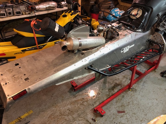

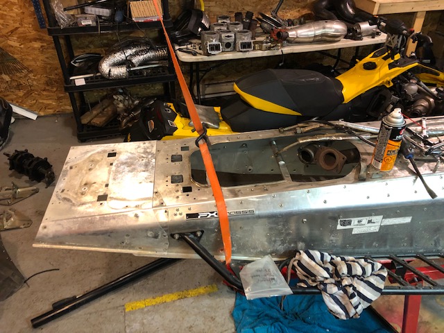

- 2010 Nytro MTX converted to XTX
Progress has been coming along. I had to take off the MTX front and rear skid mounting brackets and the rear tunnel cap. I got XTX brackets and cap installed now. While at it I went with the 141" AC skid instead of the 144" XTX skid. The MTX tunnel already had the holes for the XTX skid to the front plate was an easy bolt on. The rear I had to do some careful measuring off the XTX rear mount hole to get the 141" skid in the right location. It was about 2 1/4" back
I had to switch out the MTX 3.0 pitch drivers to a set of extrovert 2.52" drivers for the 144" 1.75 track I have for it.
While at it I decided to do a custom undertunnel exhaust off the turbo and a block off plate. I had a custom bike shop make up the pipe and it turned out wicked given the small space they had to work with.
Pictures attached.
Pictures attached.
