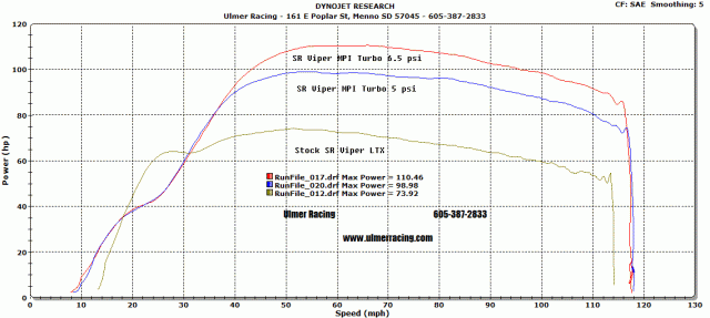

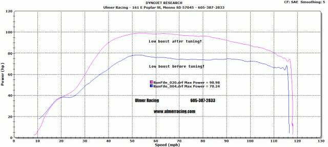

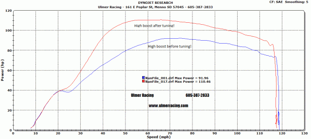

I had my MPI Viper over at Ulmers on the Track Dyno. I had him assist me on getting my boost set correctly and tuning in my clutching. Machined the secondary for 8DN blet and the primary for top end gains..... here are some numbers.
You can see we picked up 26 track hp on high boost and 21 track hp on low boost by working clutching, waste gate settings, and his hi/low boost switch.
You can see the final gains on top speed from 114.6 MPH to 123.46 MPH after machining.
Quote from Ulmer:
"Track HP vs engine HP, on our Dynojet 360 track dyno anyways, equals about 55% efficiency.
The mathematical equation I use to calculate engine HP from track HP is below.
Track HP / 0.55 = Crank horsepower
Box Stock SR Viper LTX has 73 hp to the track stock = 132.xx crank hp
Tom's SR Viper LTX set @ 5 psi had 98 hp to the track = 178.xx crank hp
Tom's SR Viper LTX set @ 6.5 psi had 110 hp to the track = 200.xx crank hp
Every engine or track dyno will read slightly different. We made 1 run at 7.5 psi that was 116 hp to the track (roughly 211 engine hp) and then we dialed the boost back down.
I can tell you that 5 psi of boost on an MPI kit will add approximately 56 crankshaft HP to the sled."

Well as most of you know I have had my issues. Finally got mine back from Allen 2 weeks ago. He went through everything incuding a bow full of broked headers, turbo mount, waste gate mount and heat shields. Missing parts on the primary and a ton of wear on the hoses and lines that ere run against frame and motor without any protection and were rubbed badly. He added the 4th injector, installed his clutch kit, fixed all of the issues, machined the secondary for the 8 dn belt. reset the boost controller switch to 9 and 12#'s and did several pulls on the track dyno to finalize clutxhing and helix. Dyno numbers at 12#'s are near 252 hp.
