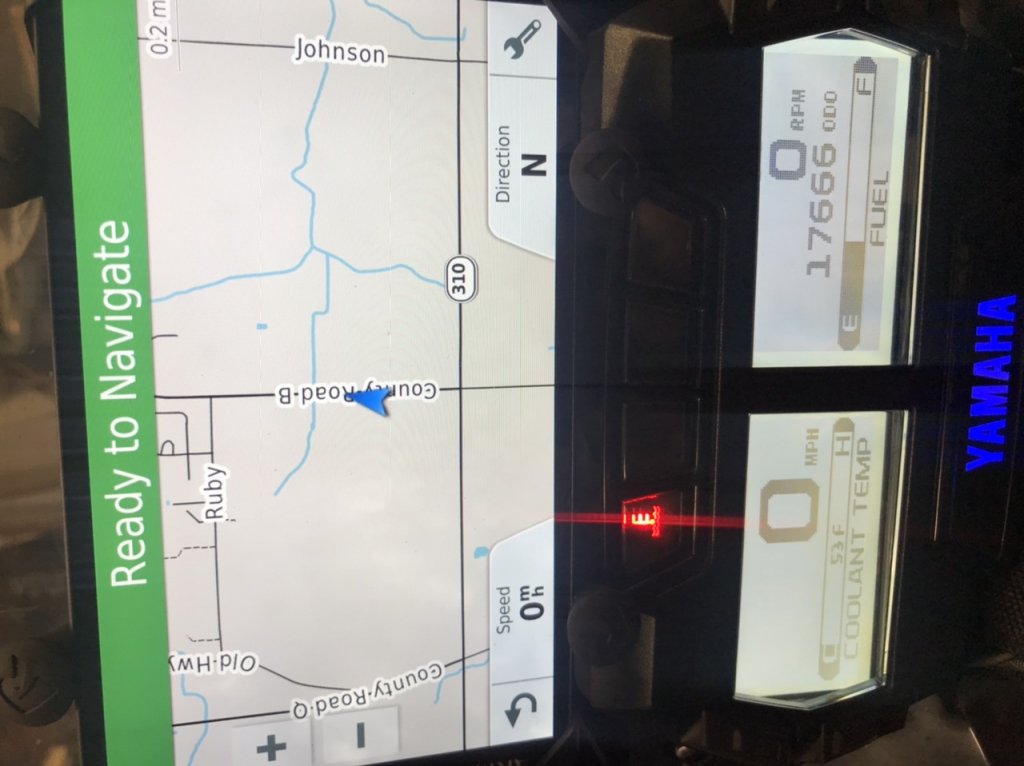

Did the case come with a heater, Or did you add that separate?Garmin Drive smart 65 7" screen with GPSTrailmaster maps in waterproof case with hardwire power, 5w heater element to keep the screen bright, mounted on BOP bracket.
Phone paired with Bluetooth so it shows alerts, texts, and incoming calls. Pretty slick. Total cost about $300.

No, heater was a separate purchase. About $5 on eBay I believe. You would want about a 5w 12v heater element. Something like this:Did the case come with a heater, Or did you add that separate?

Did you wire it in direct so its on all the time? (only when the sled is on of course)No, heater was a separate purchase. About $5 on eBay I believe. You would want about a 5w 12v heater element. Something like this:View attachment 167031

I actually have the GPS power and heat element on a switch...Did you wire it in direct so its on all the time? (only when the sled is on of course)
The switches are wired to the battery so I can turn on the GPS even when the sled is off (for navigating on the side of the trail.). Other switch is aux lights.

Did you figure out a way to get the GPS to Calculate Routes using Off-Road trails? Garmin Custom Service stated this Feature is not available on the Drivesmart Models. (Of course its available on their $800 models, lol)Garmin Drive smart 65 7" screen with GPSTrailmaster maps in waterproof case with hardwire power, 5w heater element to keep the screen bright, mounted on BOP bracket.
