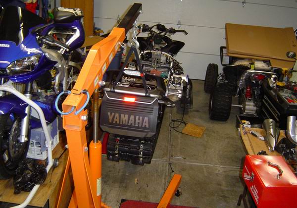

For lifting the sled up I just use a motor lift! Ha Ha Ha Works awesome and you can adjust the rear of the sled in any positon that you need it!
