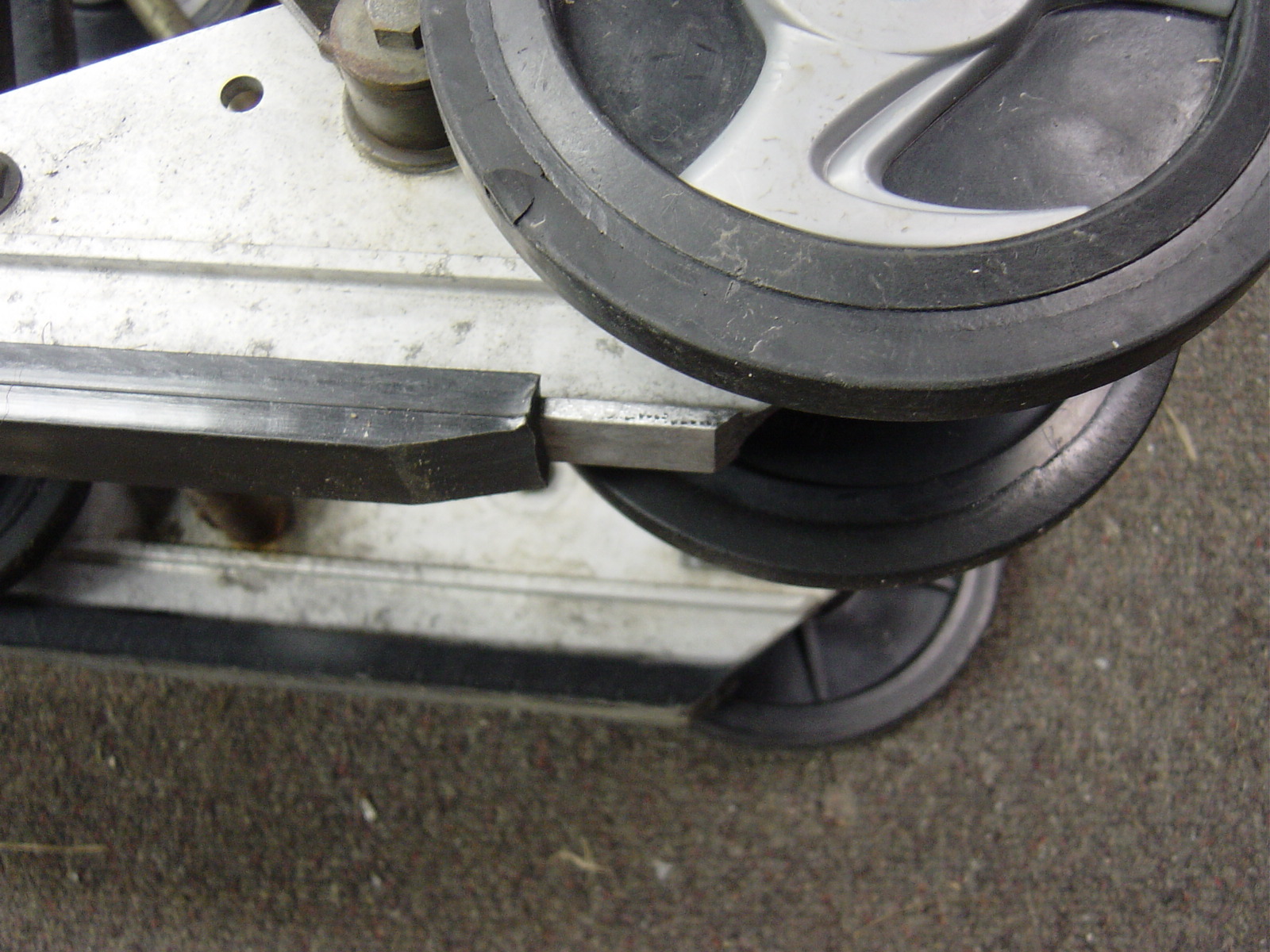

I have the skid out for some other maintenance, so i figured i would replace the slides. Got some new ones at the local stealership, installed one tonight and appears to be too short. Is this normal? I do not have the part # in front of me now but i know they did say "121" on them.

Mine where shorter also but I dont think that short.
No that is not normal go get the correct ones if they dont have them get ones that are longer and cut to fit.

Those look to me to be 06 hi-fax on a old school (03 or 04) rear skid.................Cubby
