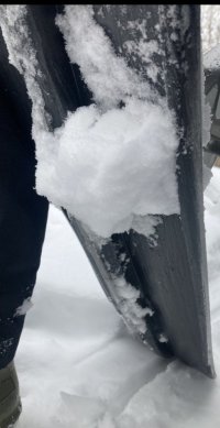

Anyone have a pic or link of the vk pro skis. I'm fairly certain it's what's on my 144 apex. Particularly im looking for a pic of the bottom. One apex I have what i think is the vk pro with snow trackers 7" wide ski handles awesome. My other apex us skidoo 5.7 with the 6"/4" combo while it's wicked too its different and darty. I prefer the wider ski but both handle really really well. I have got a new used nytro came with ca pro mtx. Sounds like there might be hope if I bolt some snowtrackers on it????Totally agree with Stubbs, Yamaha MTX skies with snow trackers, or Yamaha VKpro ski, both have the deep keel both are 7" wide, I run the VK pro skis on my 16 XTX with snow trackers, Ski was easier to source than the MTX at the time, pretty much same ski other than the rear off the ski is curved better for backing, drives straight as a arrow no tracking, way better flotation than stock skies.
Are these skis vk pro?

Those look like VK skis to me, the MTX skis were spooky close to SLP Powder Pros in profile. I like them the best.
