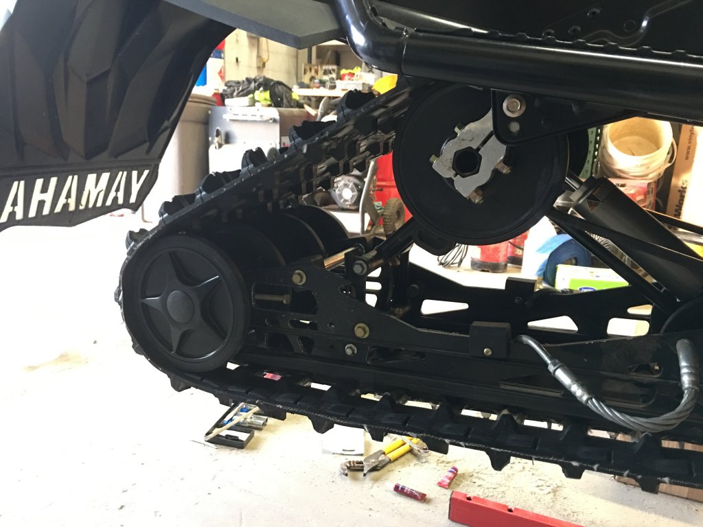

Hey guys, new to these sleds. Just picked up a low mileage 2016 Xtx yesterday. build date is 05/15. Mint shape and has the 4th wheel kit added.
Note sure if its the whole kit ditching the trihub that the previous owner did or if he just added the 2 outer wheels. Is there an easy way for me to tell?

You can see that if it’s the factory hub, the 2 wheels are bolted together with 3 bolts. It’s like it’s 1 piece

Thanks for the reply. I did figure out shortly after I posted that it's still there. . Now, I suppose I should remove and either:
a) repack bearings (these appear to be serviceable as I see the retainer clip on the inside of the inner wheels)
b) get new bearings for those same inner wheels?
c) ditch the inner wheels altogether and get something like the J&Ts or other? - If I do, I'd like to keep the outer 2 wheels - is there an option just to get the inside 2 to rid miself of the potential trihub miseries? Links? (eg - will just this do the trick and preferred method? http://www.jtatv.com/4th_Wheel_Kit_p/trihub-repl.htm)
Once the above is decided, to get them all apart can I simply just hoist the rear end way up and R&R without loosening the track?

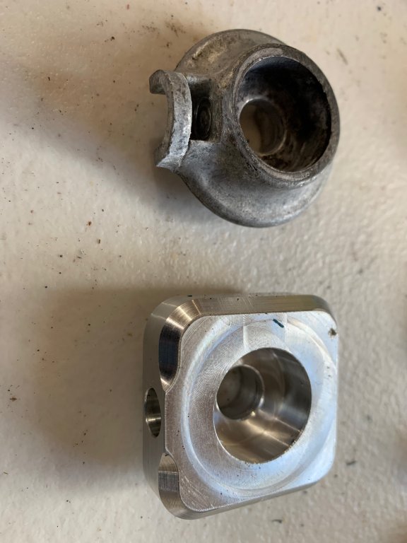

The answer is C.c) ditch the inner wheels altogether and get something like the J&Ts or other? - If I do, I'd like to keep the outer 2 wheels - is there an option just to get the inside 2 to rid miself of the potential trihub miseries?
Skip any of the fourth wheel add on kits and get the BOP solid axle replacement. The new wheels and huge bearings that Travis provides are great. It will outlast the rest of the sled and all but ensures even track alignment.
I also recommend the Grip-n-rip billet axle adjusters to replace stock as they have been known to fail. Since the BOP axle is a full 1/2" diameter, you have to drill put the adjusters. You want a beefy adjuster to go with the new axle.
You can reuse your wheels with the BOP kit.

Very easy to change by taking the skid out. Lift the rear way up, undo four bolts, skid comes right out. Goes back in easy too. While it's out you can check or grease everything else.

I have the JT wheel kit on mine and they are very nice, highly recommend. And no you need to at least loosen track all the way and it’s still tight to get out and back in

J&T, Larson, BoP kits are all good. Can't go wrong with any of them IMO. But the tri-hub must go!! Mine bloew out at 1, 600 miles leaving me stranded and tough to tow. The kits are well worth the insurance. Four seperate wheels with individual bearings....

Welp, got around to taking it apart this evening. Pulled the 2 outside wheels off, then when pulling the rear axel/trihub out one of the "wheel guides" clutch side was split in half - came off in 2 pieces. Guess I need a couple of these now. According to the part diagram its this: "wheel, Guide 1 8JP-G7534-00-00".
Are these normal to break here and there? Also my snap ring pliers fell apart into pieces in my hand upon first use so I shook my head, had a beer, and called it quits. Anywhere in Ontario canada to pick up a J&T or BoP upgraded center wheels/trihub kit fast? Hoping to also to keep the outer wheels on there (4th wheel kit). Im in Ontario and don't really want to wait for shipping from the states if I can help it.

http://www.gripnripracing.com/index.php?id_product=136&controller=productWelp, got around to taking it apart this evening. Pulled the 2 outside wheels off, then when pulling the rear axel/trihub out one of the "wheel guides" clutch side was split in half - came off in 2 pieces. Guess I need a couple of these now. According to the part diagram its this: "wheel, Guide 1 8JP-G7534-00-00".
The Rip N Grip option is a perfect pairing with the J&T kit.
