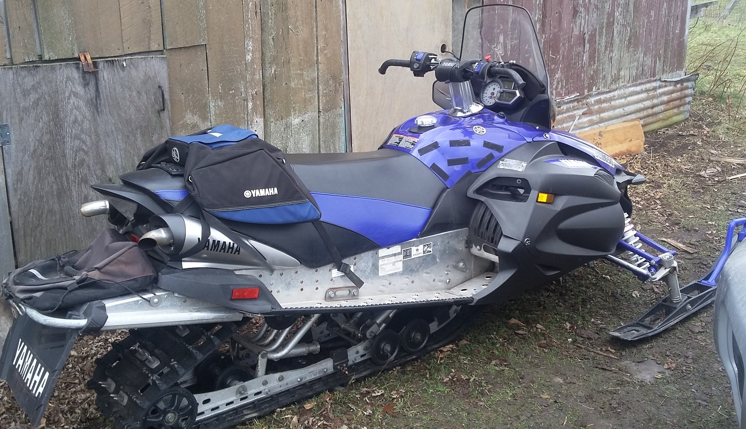

just got a 2007 apex, looks like its in good shape .
but it wont start the guy says its spark plugs . so thats were im going to start ,, any thing else i should check for in the engine.
turn key on , fuel pump come on , cranks over good , kill switch in not on, so good there, sat for some time , thinking possible even bad gas , but it smells ok,there isnt a petcock is there .
