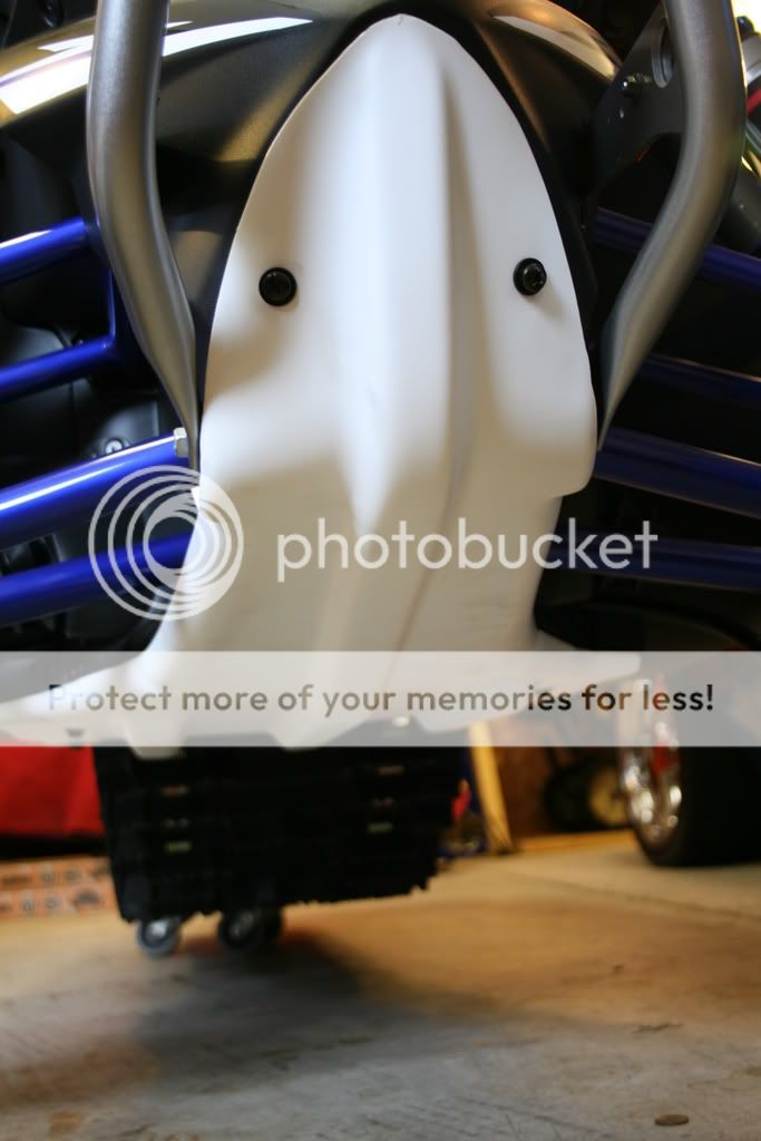

First mod for sled is a simple one. New white skid plate.
Planning to install A-arm protectors when I can find a set. I hear http://www.muffinworksltd.com/ are fabricating some for us Nytro people. They currently make white ones for the Apex and Phazer.

NICE! I like the white skid plate. I think I'm going with that over a "float plate".

The sled looks great! I also like the white skid plate. I was thinking of going black but the white really looks good.

I was actually thinkin blue, but I keep reading that the blue windshield, A-arms, and cowl are all different blues and I didn't want to risk adding a 4th blue to the mix.

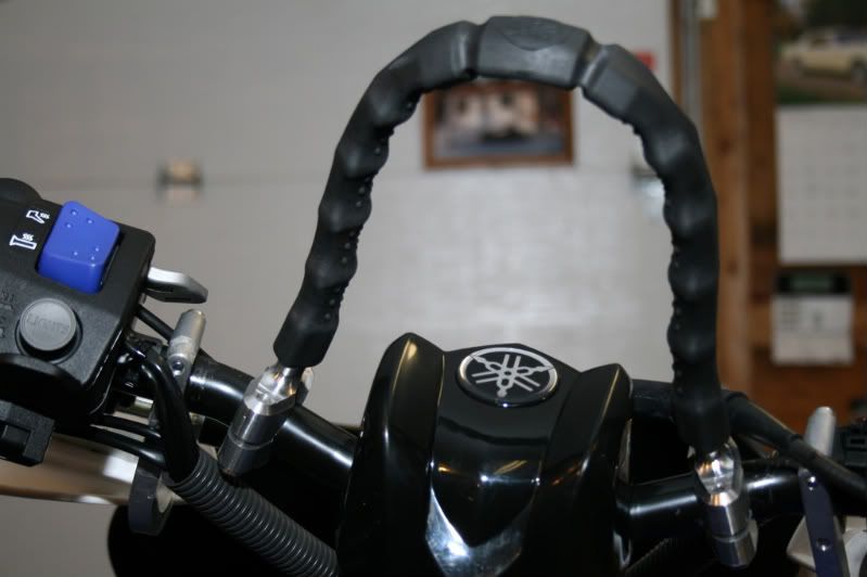

I gotta have a mountain bar on my sled. Bought one from Royal for
my VMAX 700, worked well. This time around I went with this style. I wanted the one on the mountain Nytros but the bracket is welded on the handle bars so... Very easy install.
Look it even has some billet on it, LOL.
