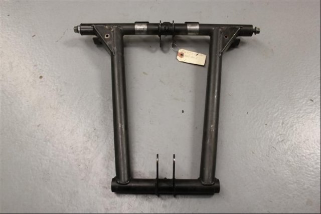

Grizz narrowed down this afternoon. It was all kill switch!!!! Fixed now on to the torque arm they welded like crap does have the right geometry. Need a whole new one!!!

This the right torque arm for an 05 with the duel shock system??

No, that's wrong you need this one: http://www.ebay.com/itm/YAMAHA-RS-V...DefaultDomain_210&hash=item259abc2efc&vxp=mtr

Part number for a new pivot arm is: 8ES-47331-01-00
Yamaha Sports Plaza has it listed for $135 so a used one should be under $100

Lol you're good!! I need the bar in it too is my guess. I will order this one or have a good looking one in hand tuesday. Thanks soooo much for bearing with me. Back up lights on the trailer worked when I hit my driveway. Will connect the wires better and see if that works. If I do order one can I ship it there?? Thanks again. Tim

Thanks 4 stroke sent them a message. On ebay nbgmotorsports has a pivot arm #3 is the inventory number they have tagged it with. On totally yamaha it look like they have a newer version than my trashed one part number is now 8ES-47331-01. #1 will the nbgmotorsports one work, looks like it has some funky tabs on it.
