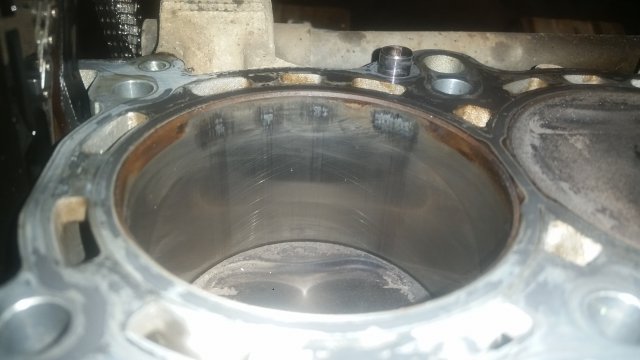

Got it home did a compression test and had 20 40 and 55 psi in cylinders. I am going to post pics of cylinders for some of the gurus to check out and let me know thoughts. Should I have head shaved as I know from just putting a straight edge on it it's warped. Please share your thoughts.

yes, thats my plan. but i wanted some opinions about the cylinders. you can see in the pics at the tops of cylinders only on the exhaust side, there are some scuffs from pistons. what i want to know is what thoughts are on just lightly cleaning them up and having head shaved would be feasable. or should i do a complete rebuild or just topend. im hoping some of the guys here like grizz who have had experiences with the warped heads would chime in and give their opinions. thanks for suggestion though. and im hoping that i can just have head shaved and be good to go

Hone the cylinders and check plating for nicks.
